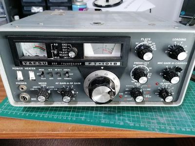

The Yaesu FT-101B - the Sherman tank of radios

Then on Thursday this week my eyes lit up, a Yaesu FT-101B in 'unknown' condition but appearing complete, i.e. all knobs and dials. Then I looked closer, there was also a Sommerkamp FT-277E (Identical to the Yaesu FT-101E) in the deal too. A quick search for FT-101 parts revealed quite a range of bits at sensible prices. These had no mics or mains leads and the Yeasu featured some sort of audio processor too. A quick glance at the specs on other sites showed these are 1.8 Mhz to 29 Mhz receive and 100 watts SSB power on Tx and the Tx side featured a large number of FET stages and transistors while the transmitter uses 3 valves. A great combination for robust radio. I later found out that is has a fairly unique arrangement of a large mains transformer which can run the set from 100, 110, 117, 200, 220 , 234 volts AC but amazingly also feed 12-13.8 volts DC into the built in invertor using the same transformer. This will generate the required output voltages of +13.5, -100, +160, +300, +600 volts DC. Even 100 volts AC for the cooling fan which operates only when transmitting.
Now these where being sold on behalf of an operator who had passed away, they where also finishing the bidding at 2:00pm when most people are at work. I work from home so easy to bid and there was only one bid on already. Let's just say I got it for 2 GBP more than the starting bid. So here they are cleaned up -
