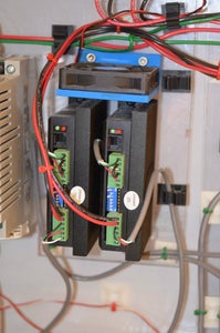

Step 4: 2 Axis CNC Lathe Overhaul

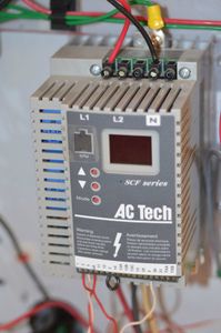

For the longest time my school's engineering department has had a small CNC lathe but i'd never seen it get used. when looking into why I found out that the control system was buggy and outdated. After consulting the department chair and showing him my previous projects, we decided that I had a $1000 dollar budget to rebuild the lathe. I decided to replace all the electronics,the old cheap servo motors with more powerful steppers, new digital stepper drivers, CNC USB MK2/4 controller, and use the current 3 phase motor controller inverter. After many weeks of working during lunch and open hour here was the result. As to this date the machine has been moved from it's temporary work environment and we are struggling to find a breaker that can supply enough current to the Lathe for more than a few minuets. Other than the power issue, the lathe is nice to have back for students, robotics, and science clubs to have at their disposal.

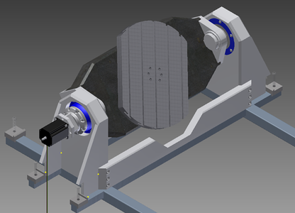

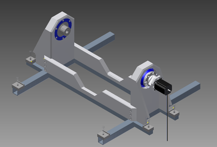

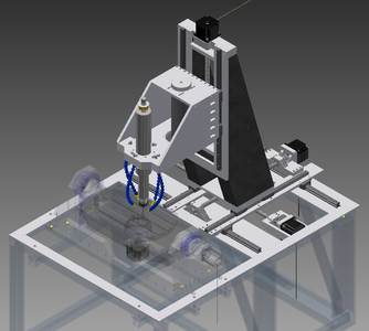

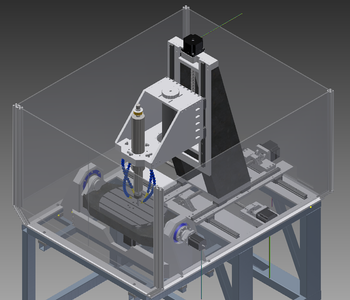

Step 5: One Last Hurrah, a 5 Axis Mill.

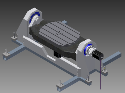

All of my previous projects have been building up to one last CNC build before leaving for college in fall of 2016, building a 5 axis Mill. Serving as a Independent study in advanced CAD and CAM manufacturing with Autodesk® Inventor Professional® and Autodesk HSM®, to date all aspects of the machine have been CADed and I am beginning stress testing and computer simulations as well as getting some of the unique manufacturing aspects contracted. (My dad gave me a $1000 budget to build this machine excluding anything we already have).

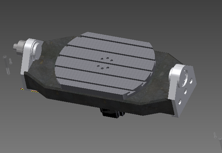

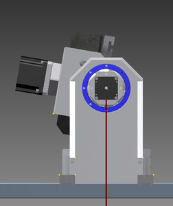

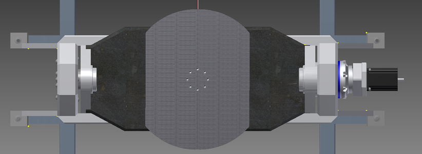

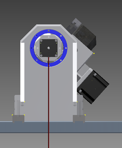

The machine will have a 18x15x15 inch work area with 150, and 360 degrees of freedom in the respective A and B rotational axis. I'm using the same Aerotech ground ball screws on the 3 axis mill for the Y and Z, and purchasing a similar ball screw for the X axis. All of the linear rails are THK HSR or HR 25, or 20mm rails.For the A and B, I have two 61:1 Alpha gear reducers with 4 point contact ball bearing gear heads(less than 3 arm minuets, +/- .0001 degrees of backlash). I'm purchasing a CNC USB MK3 Ethernet/USB controller for the control system and using 5 parker PDS-13 Stepper drivers. For the spindle I have a 10,000 RPM spindle with ER25 collet and a 5000 RPM closed loop servo geared up 2:1 to power it (the closed loop feedback servo allows for taping holes with taps and making threads with other similar tools). I'm using a brushed servo controller and servo AMP to power the spindle motor. I've also decided to invest in a full blown coolant and misting system, water proofing and and at a minimum water resistance will be added to all components in the machining area. Polycarbonate shielding and coolant collection systems enclose the machine.

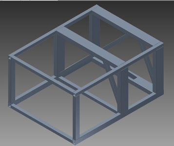

A unique problem arose, how to build a accurate, stiff, low cost machine, without using cast iron as most mills use. After considering of filling aluminum boxes with concrete, sand, cat liter, etc; or using steel tubing with similar fillings, I decided to go out of the box. The 3 largest parts of the machine will be granite, the A table, and the vertical supports on the Z axis, respectively 3 and 4 inches thick. These will be CNC water jet cut by a local granite shop on their 5 axis CNC, typically used for counter tops. Above are photos of the machine's CAD models and many of it's main mechanical attributes with text captions.
