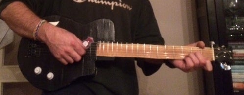

Step 9: Finallizing
So the last steps is to put all parts together. U need to make a hole for the pickup. Easiest is to start making small holes with a drill and then use a stick saw.
Drill holes for the tuning screws and screw them tight.
Decide where you want volume and tuning control and your output jack. Since I bought the kit its rather self-instructing how to do. As you can see in the image above I couldn't put the pickup straight. This is to compensate that every string is straight above every magnet in the picup.
You need to screw the bridge in place. You need to know where it will be to calculate the fret positions last step.
To make it more robust I glued some wood under top top of the guitar for the screws to the bridge to fit in.
You also need to attach the backside of the guitar. I made the backside from a piece of spare ply wood I found. The backside of the guitar is about 5mm thick (1/5"). It was painted together with the rest of the body.
I have a very simple setup where I connect the guitar to my iPhone using an iRig and to a bluetooth speaker via a 3.5 mm contact. I bought my iRig at (you've guessed it already!!) ebay
