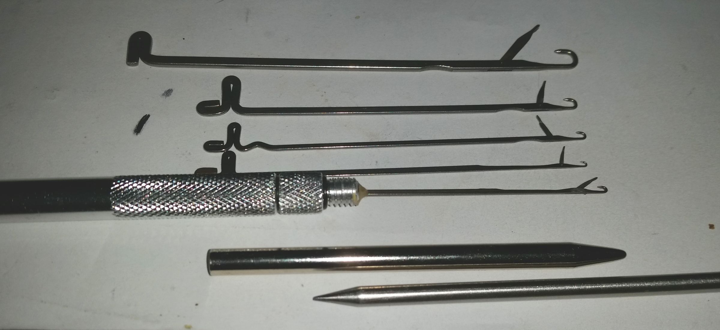

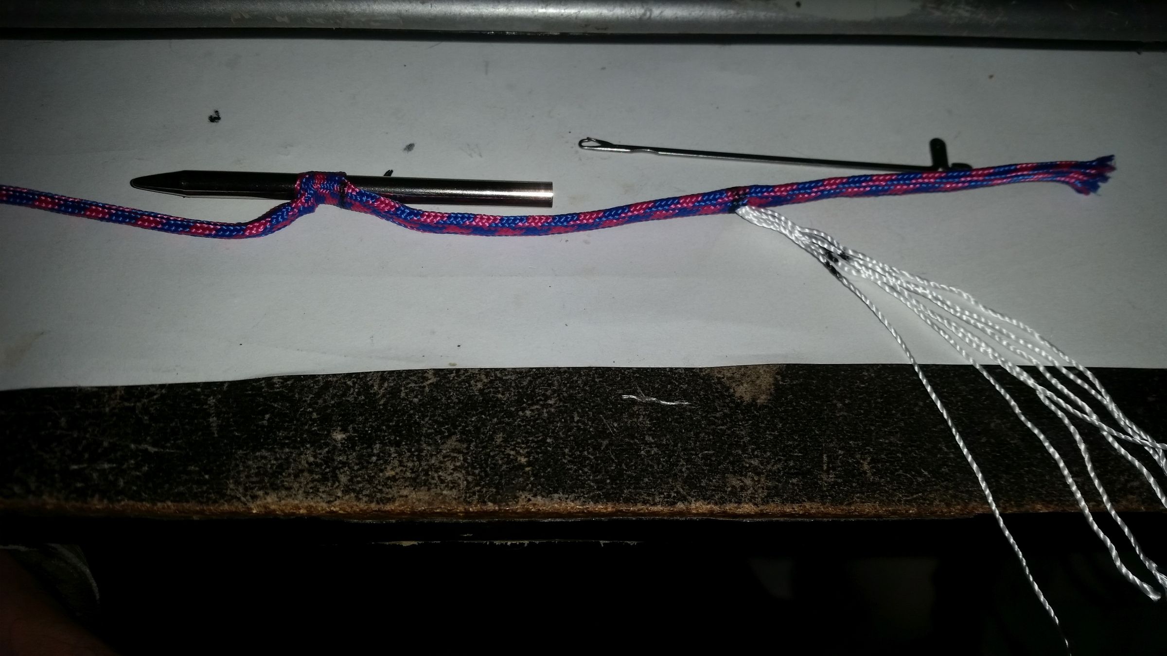

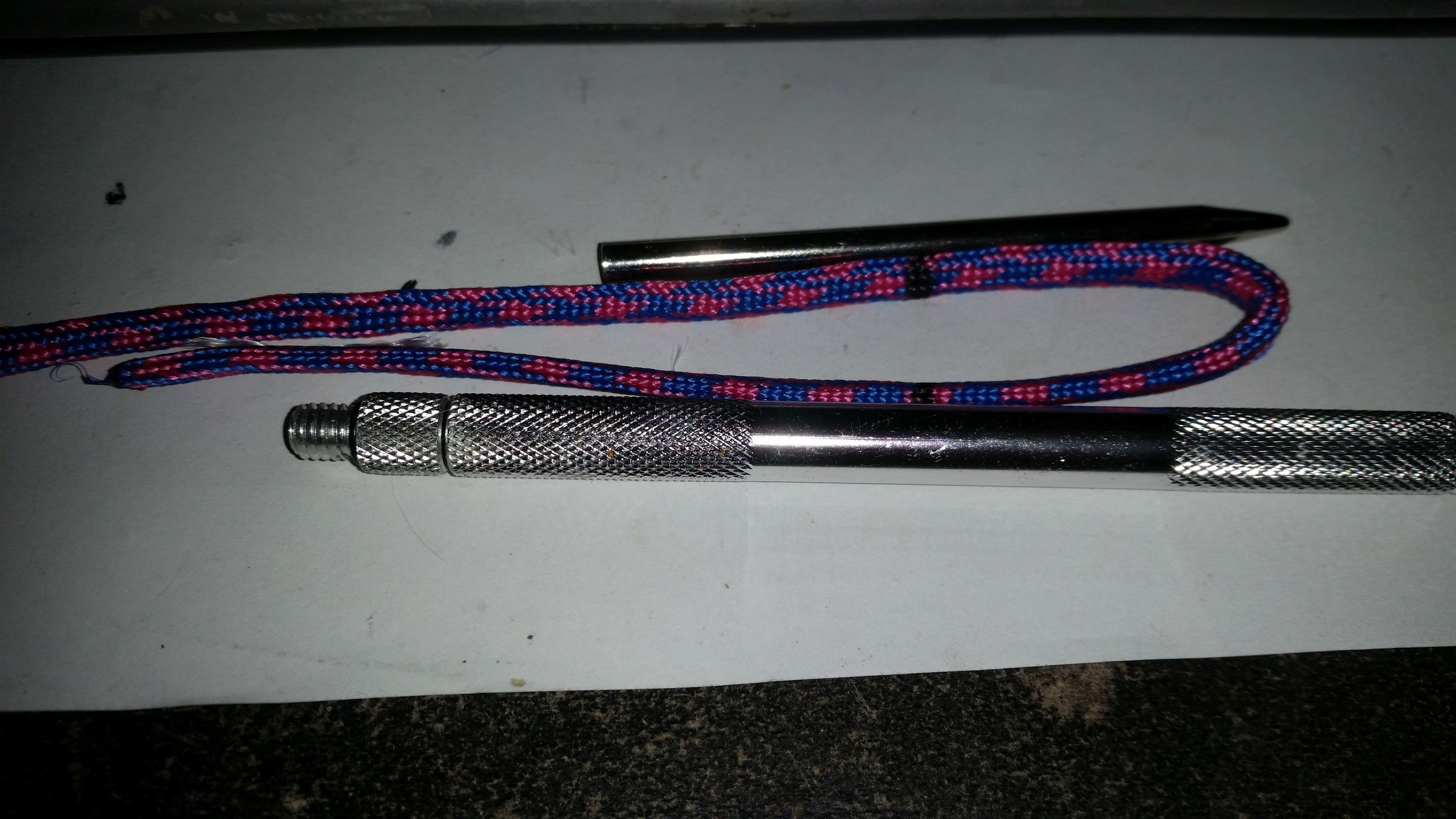

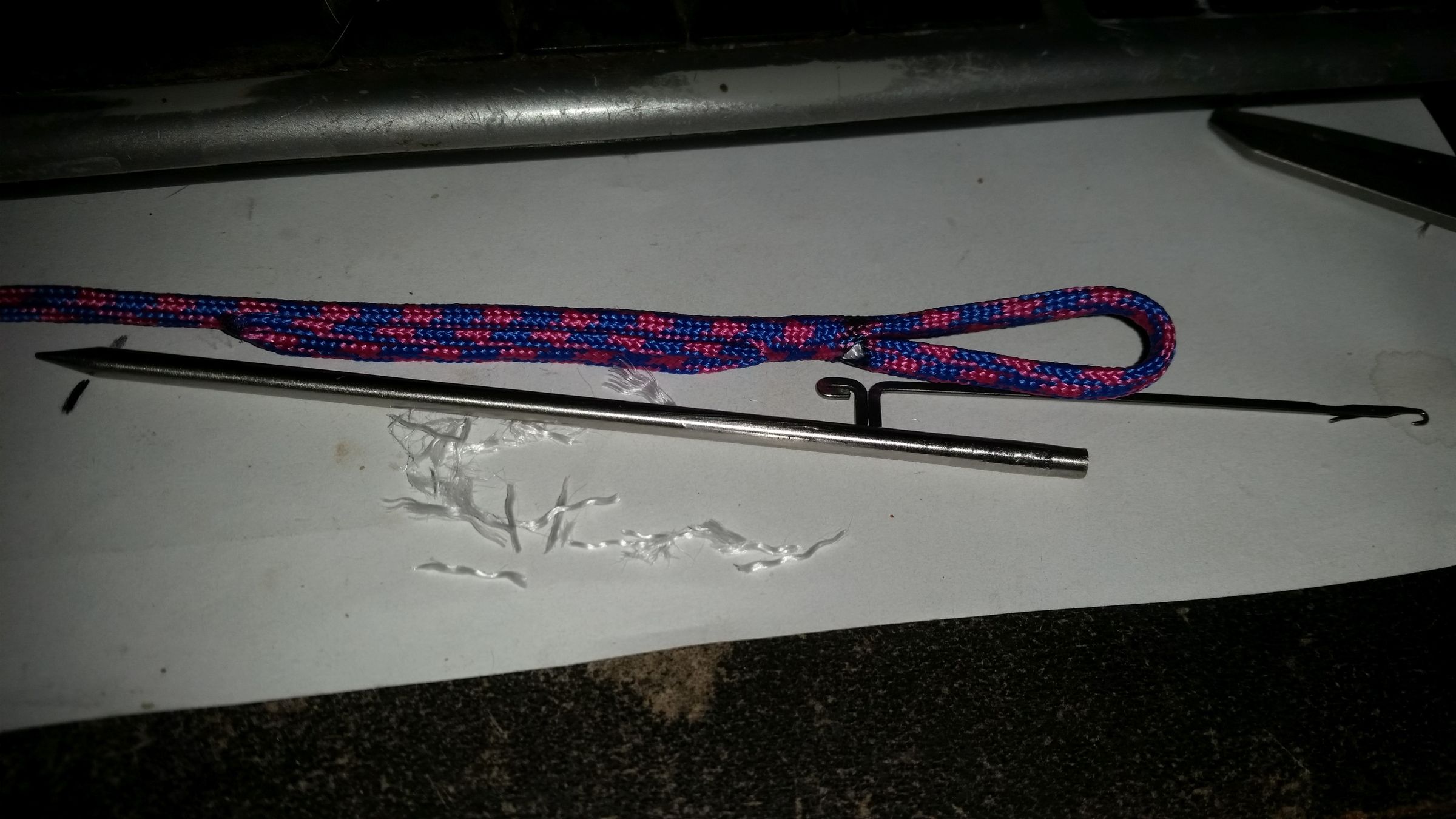

In the last step you could see some of the tools I use through out this Instructable.
For this relatively simple task I will use a standard fid and a hooksize that fits the purpose depending how much the core lines dare to resist me.
Please check the pics first to get a quick overview of what I am doing.
I will explain some of the steps with more detail with the images but it really helps to see it develop first before actually reading the explanations.

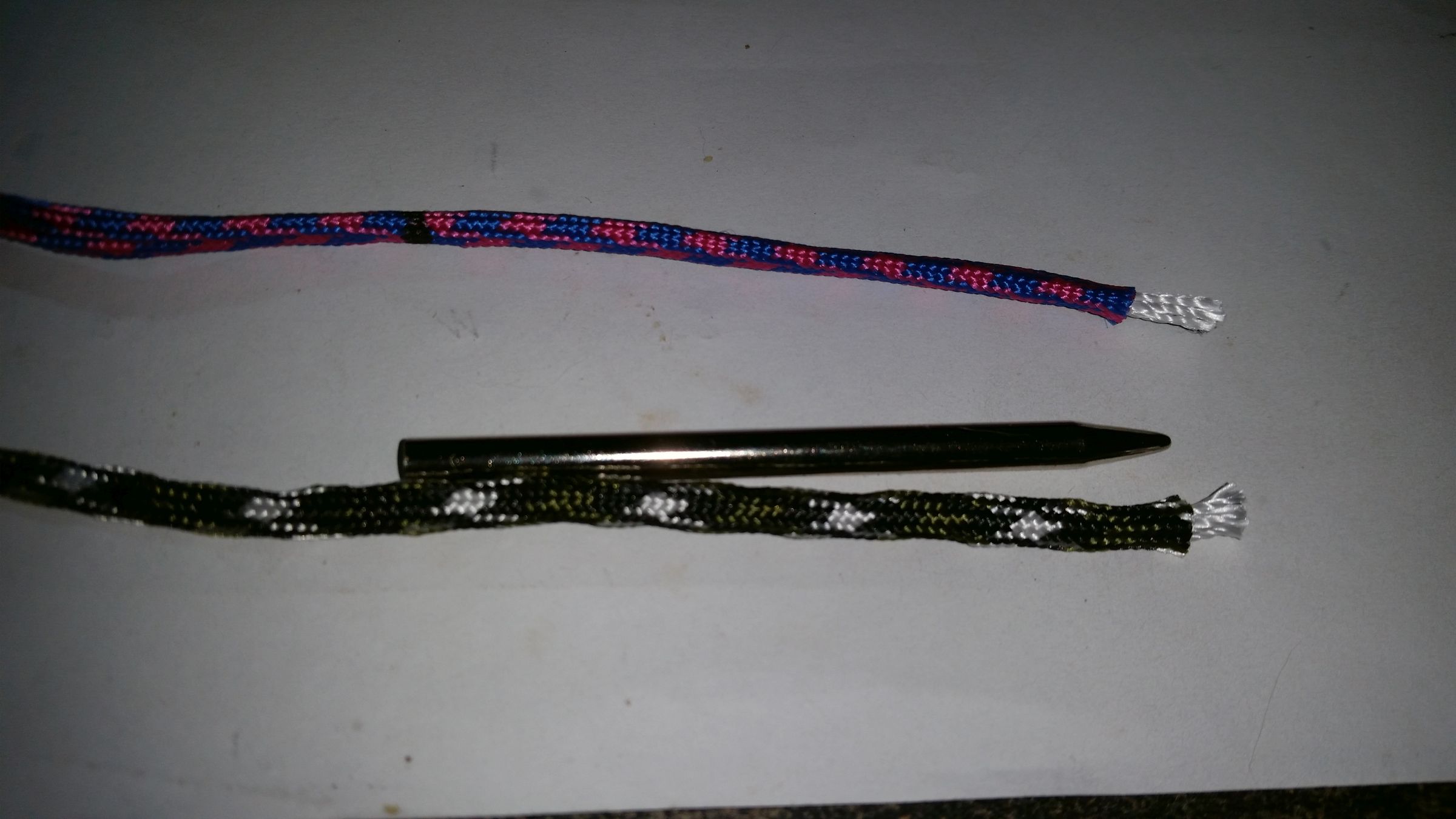

We start by marking the two cords so we end up with equal lengths on both of them.
For a standard connection where maybe not all the strenght is required you can go quite short.
I suggest to simply use the length of a standard fid as a guide as seen at the start of the video.
When working with long lines you should stretch the sleeve and then secure the line with some nice knot.
I concentrate on the splice only.

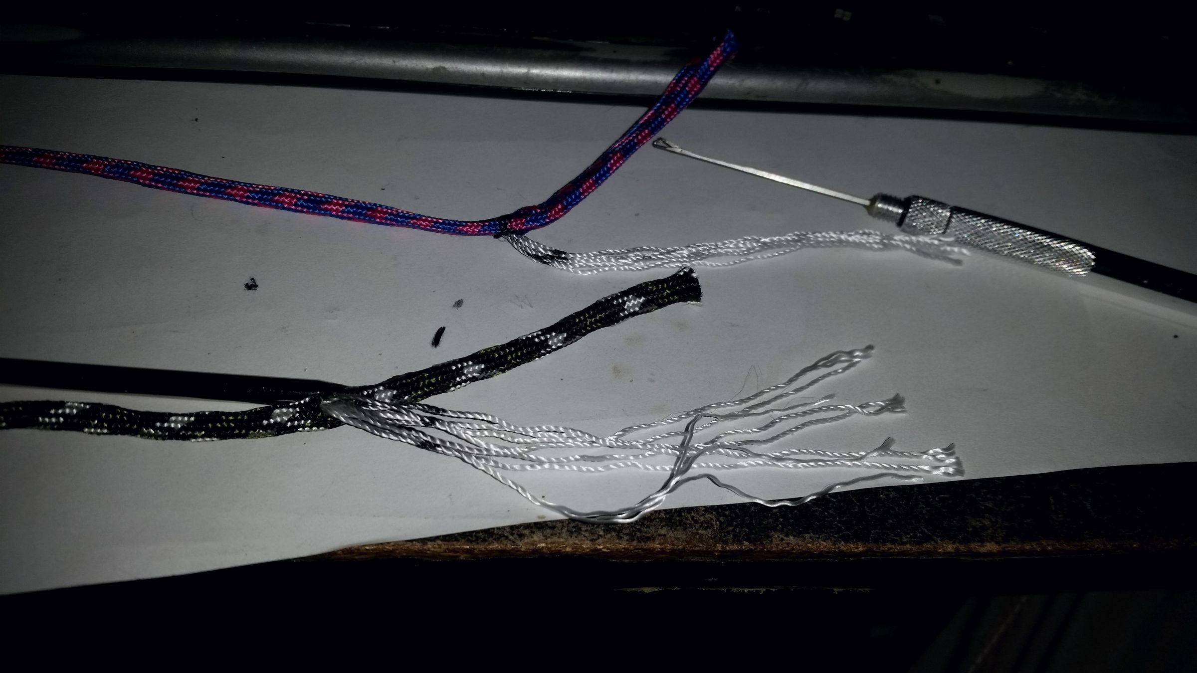

After marking the sleeve use the fid to open the cord and then mark the inner lines as well - this will make sure sleeve and cores are at equal lengths when we are done.

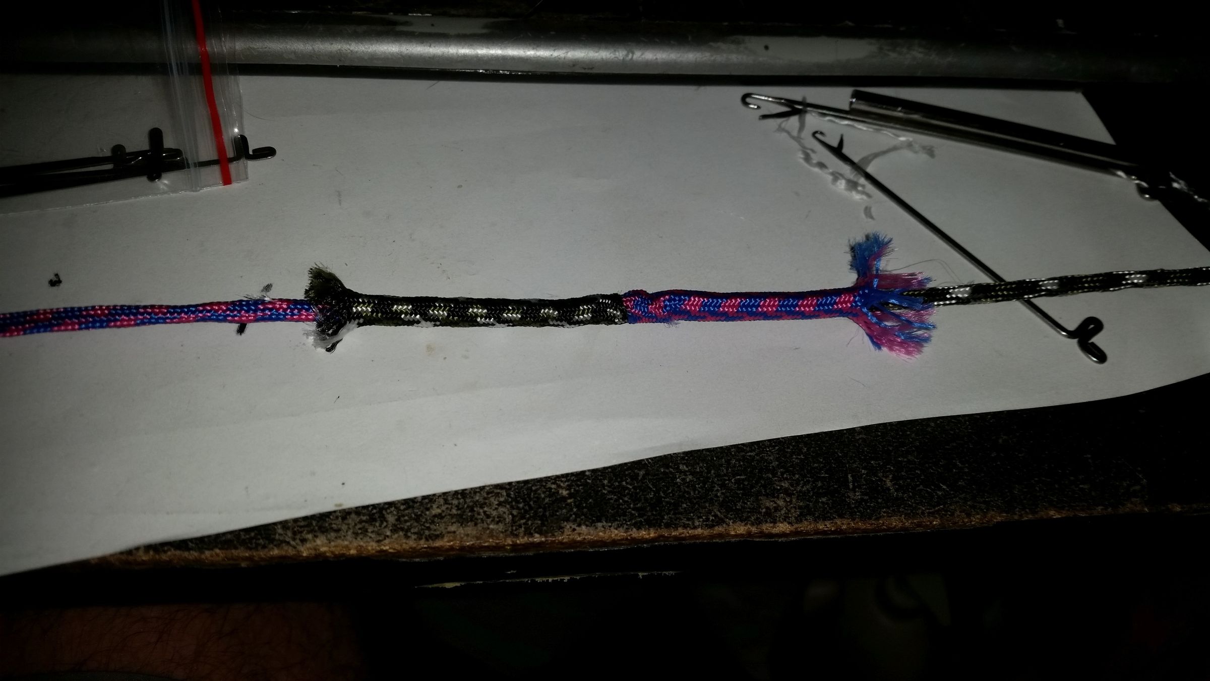

If you know the "Brummel Lock" or the "Manny" for gutted cord you already know that we need to literally lock the two sleeves of the cord to support proper loads.
However, the core lines are what gives the cord the actual full strenght.
The Brummel Lock in it's standard form works for ungutted cord as good as gutted but it does not support the maximum load this way.

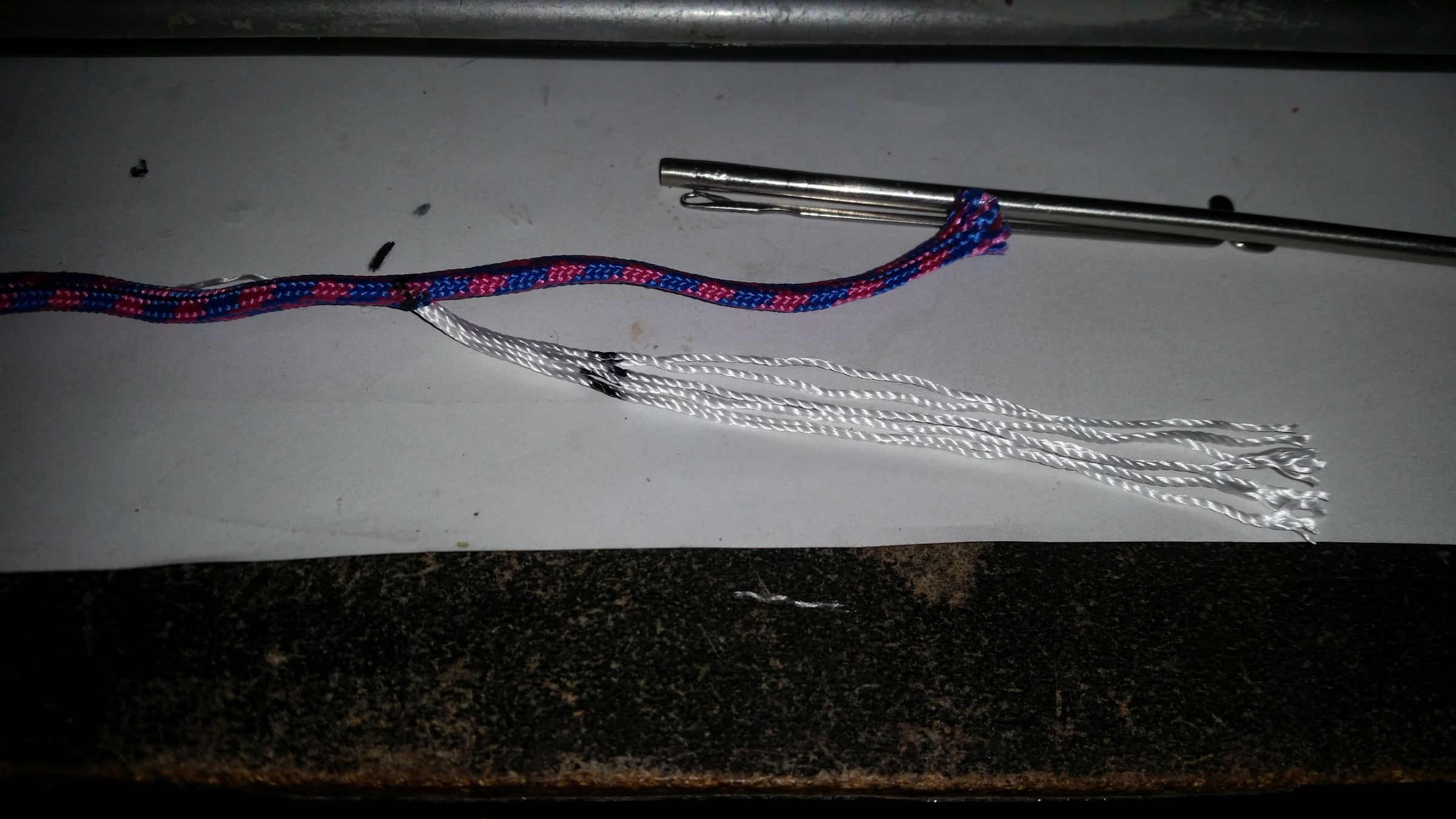

To overcome this flaw we need to get the core lines out of one sleeve and inside the other sleeve - at the point where the cords are locked.
This is the reason why I removed the core lines.
I also don't use simple holes for this lock but instead feed the needle through the sleeve a bit - about twice as long as the cord is wide.
This is to provide a better compression for the core lines once everything is pulled tight.

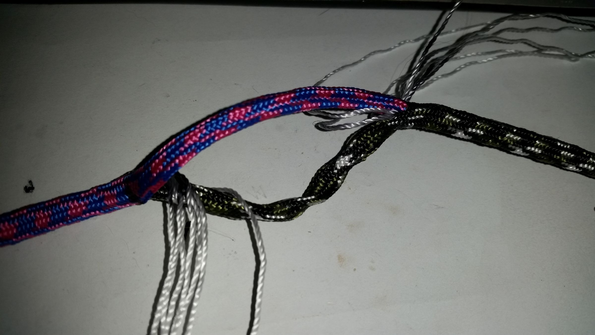

Pay close attention where and how you lock the sleeves!!
You need straight access for the core lines to go through!
In the next pic I twisted one sleeve to show you how bad it would to leave it like this - I fixed that right after taking the pic.
I used a hook to get the core out but you can do it the way you prefer.

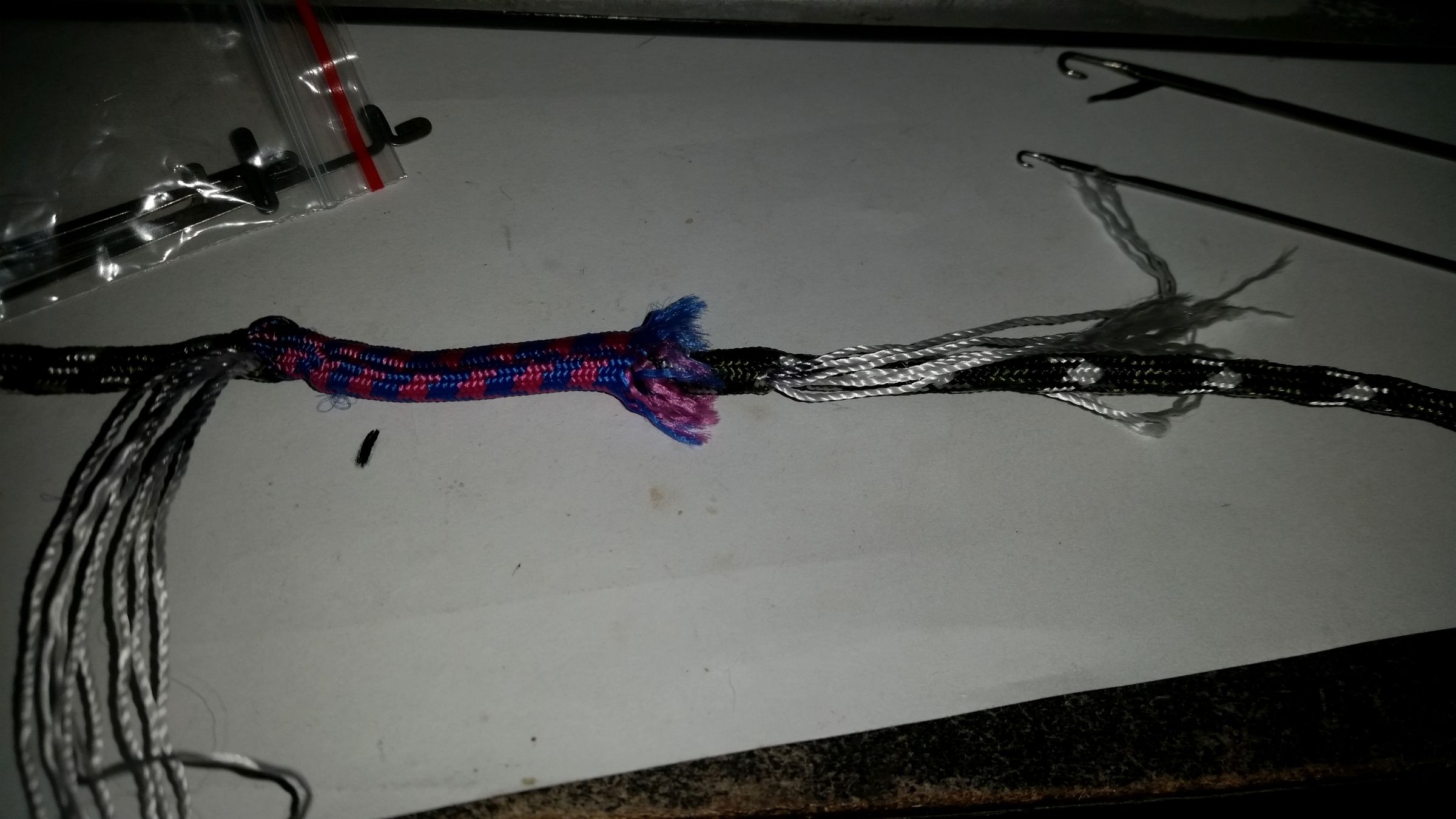

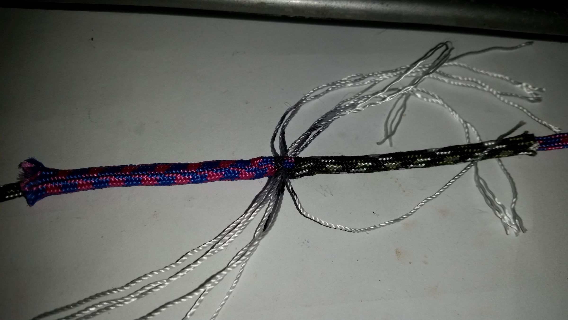

Now the other ends of the lines are fed through the gutted cord to create our lock.
On longer lines it pays off to have metal tube for this feeding to prevent the core from bruning the fibres when pulling it through.
We would have a secure lock on the sleeves if we would pull it all tight together right now.
But like this we also have lose core lines, so let's fix this, shall we?

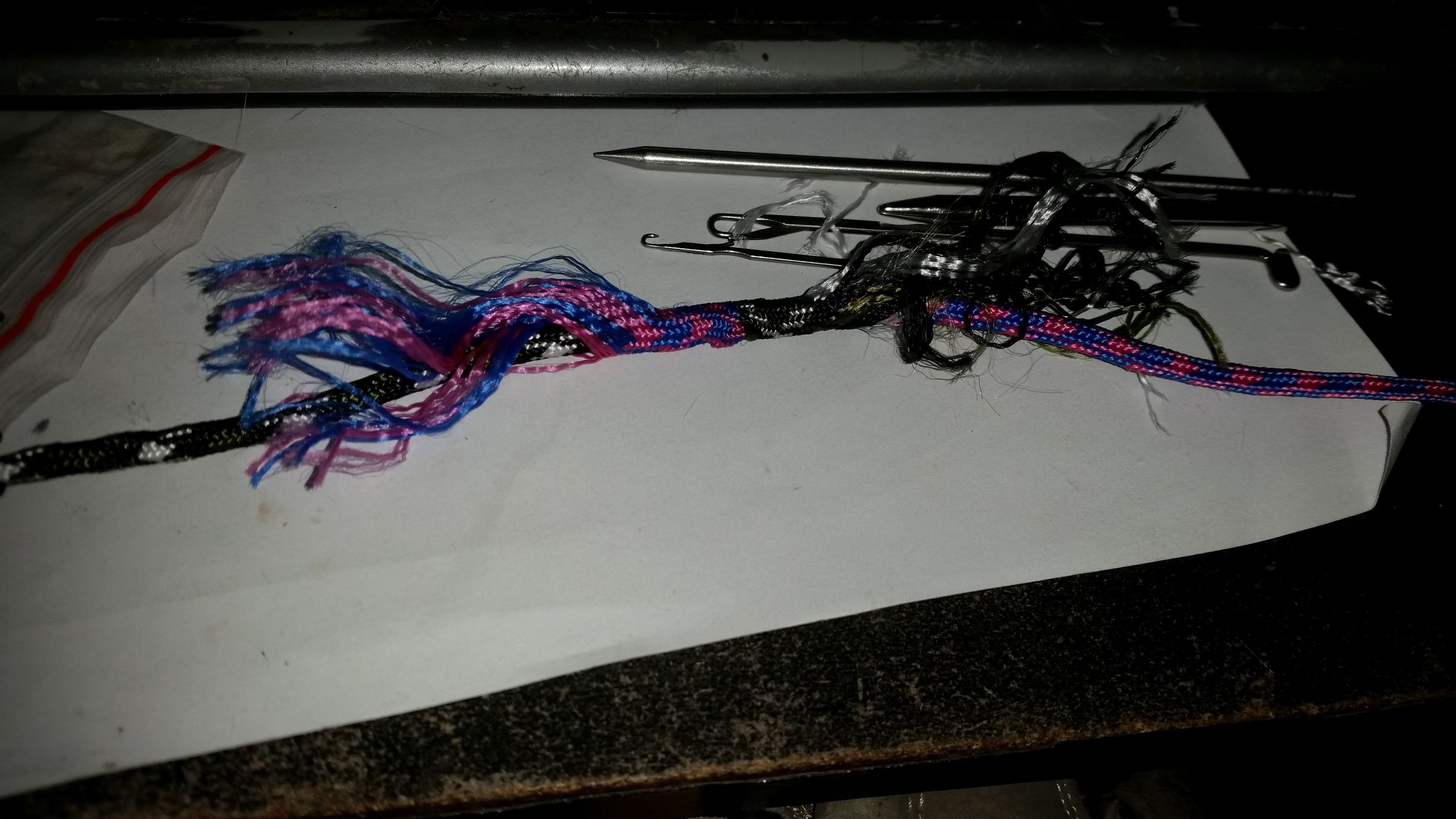

It can be a bit tricky to pull on the core lines and sleeves together until the markings on the core lines are right in our hole.
I prefer to do this in two stages, meaning I pull the sleeves first and then pull the core lines or stretch the sleeves.
Again I used fid and hook to feed the cores lines to the outside, making sure I have enough sleeve compressed so the cores will go fully inside once stretched.
To make sure we have a smooth transition the core lines are thinned out towards the end - I do this step right before pulling it all in.
If you have the markings on the core lines quite far out as a bit above image shows then stretch the sleeves first to get the markings as close to the joint as possible.
It will take you some pulling and stretching to get the core lines back into the other cords sleeve.

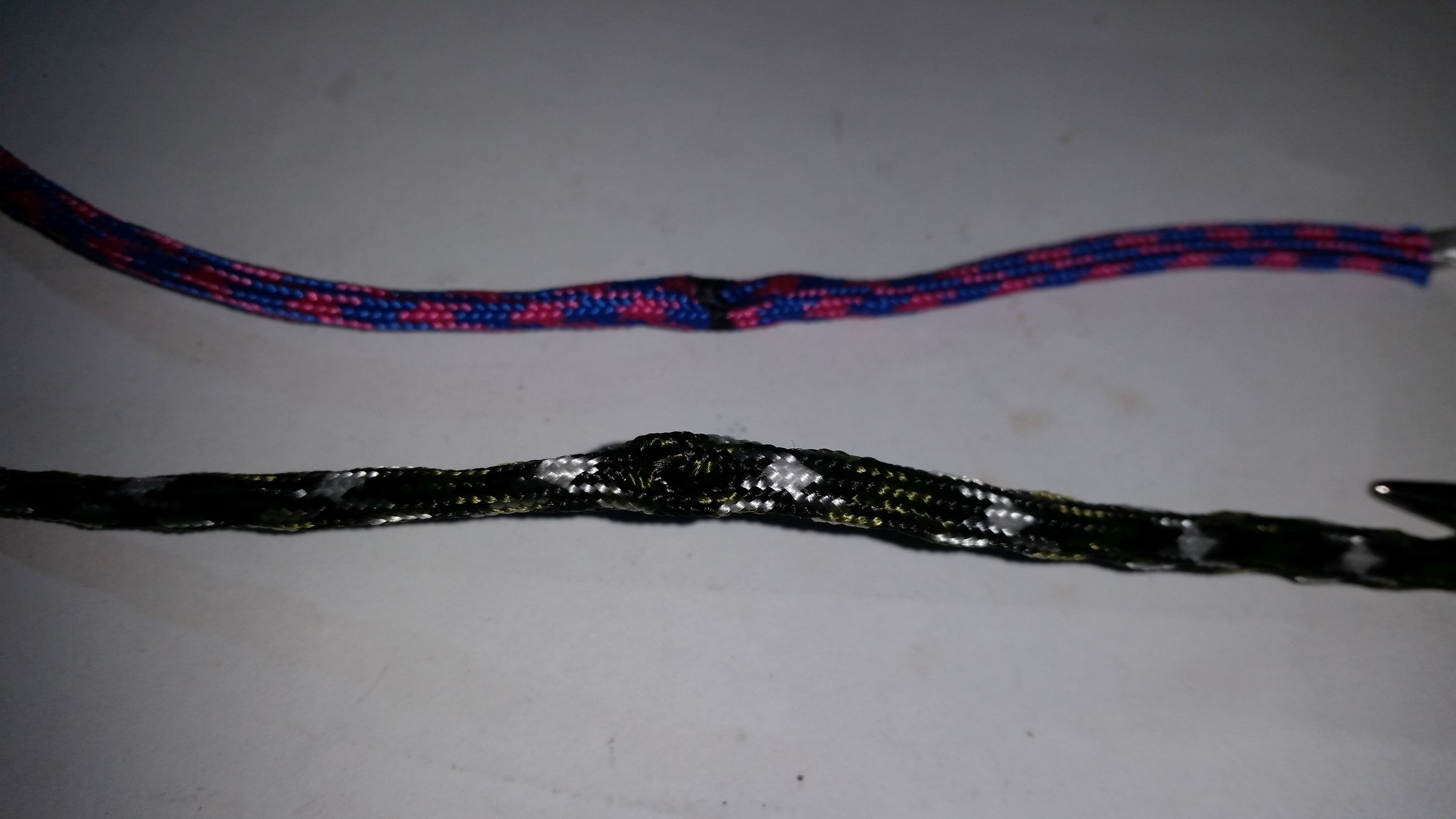

The sleeves are still compressed, when stretched out I inserted the hook about 2cm above the length I need for the core to disappear.
The core lines are now gone after pulling and stretching the sleeves but we still have this rather ugly looking sleeve problem....

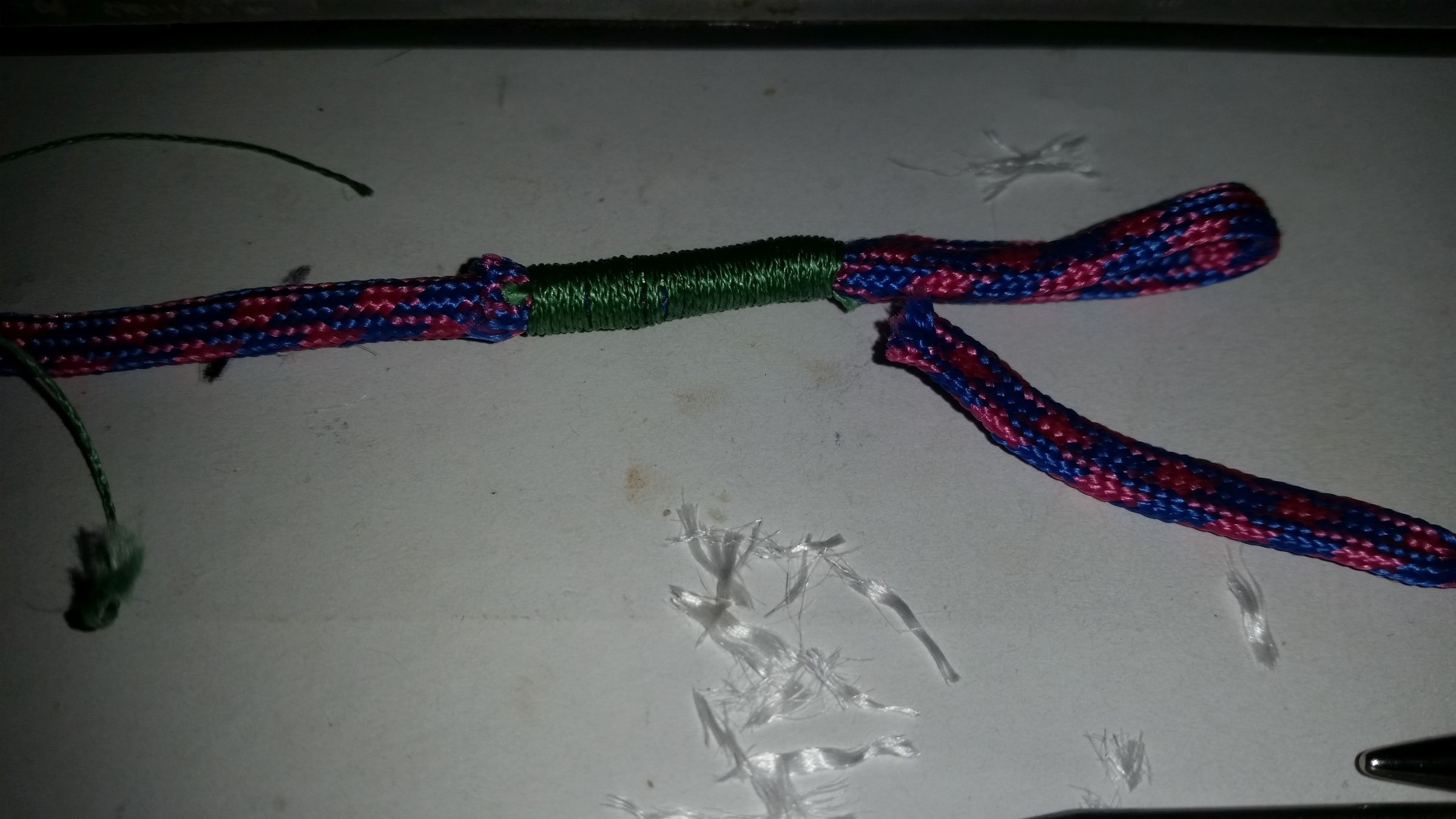

If you don't mind or even prefer a bit of stiffness you can now use waxed dental floss to make half hitches around the sleeve, starting from the joint area in both directions.
You should fix the cord between two mounts to keep it under tension and then pull the free sleeves and secure them with a rubber band or so.
Like that you keep the cord as thin as possible.
This is the prefered option for maximum strength but for this you need to pull the knots with the dental floss or braided line really tight after making sure the sleeves and cores are aligned properly.

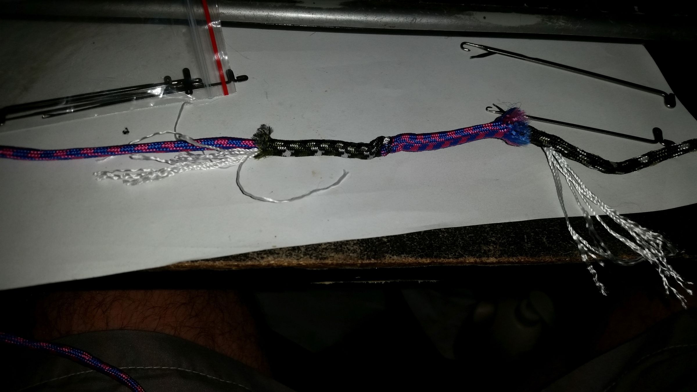

For a better optical look and better finnish we can also make the sleeve ends disappear into the other sleeve.
To do this we first open the sleeve to get the more individual strands.
Next step is to pull them through the core like before with the core lines.
A nice finnish is done with careful opening of the webbing, I did not care too much...
I also fed it all through one hole, using two on oppsite sites of the sleeve looks even better but is really hard to do properly as everything inside is pushed around as well.

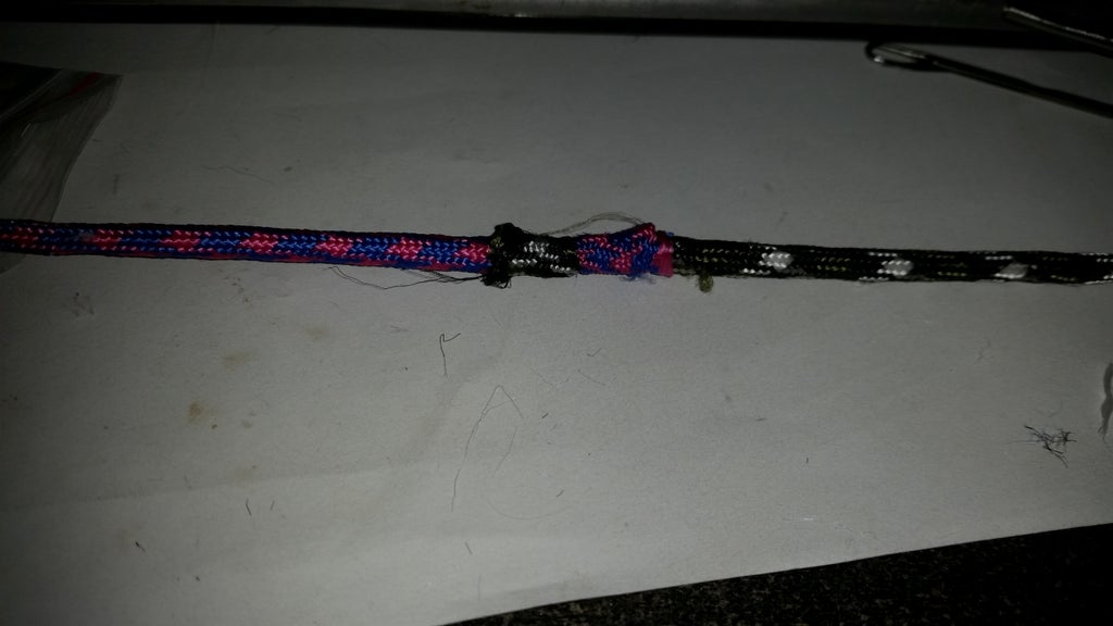

For the use in pulley systems or similar I still suggest to add some dental floss, otherwise the connections done now.
In the next lesson you can see the difference in appearance when just wrapped with braided line.

So the tools you use should be able to withstand some level of abuse.
The worst you can do is damage the fibres or feeding them through loops.
If done properly and for max strength with at least twice the fid lenght in core line to go into the other sleeve, the load capacity should be still over 80% of our 200kg target area, 160kg.
With dental floss half hitches pulled really tight over the exposed sleeves you should get 90% or more.

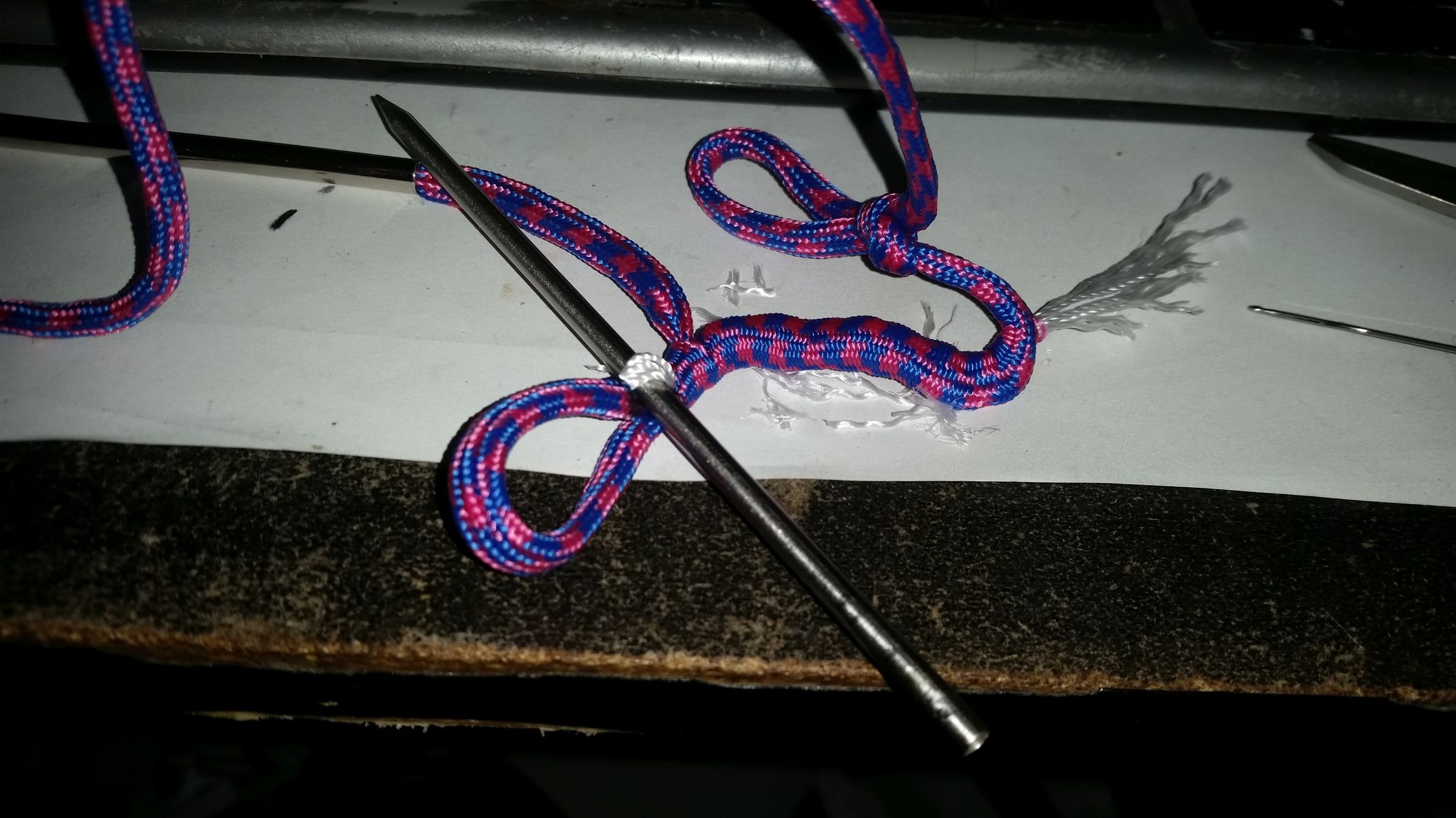

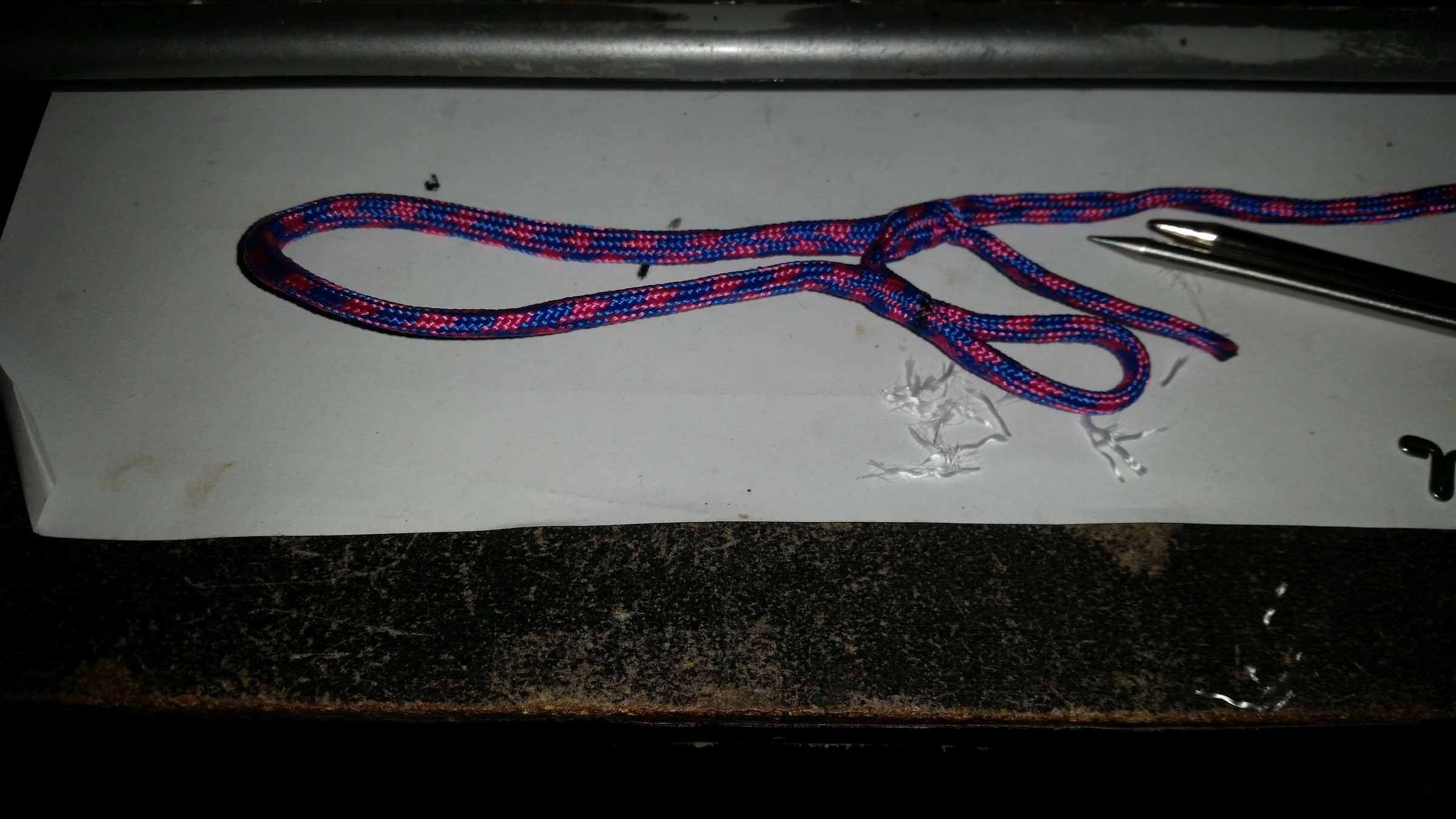

What we do differently is again to take the core lines out after marking them and the lenght we need for our eye.
Again check the pics first they basically speak for themself.

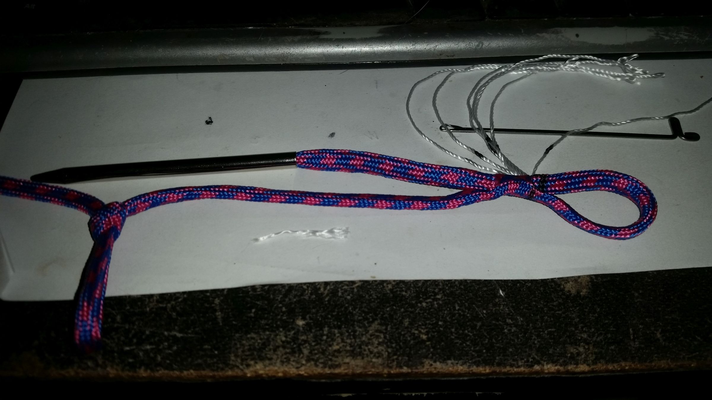

After taking the core lines out where the eye ends - at the short end of the cord, we make a Brummel style splice with the sleeve as usual.
At least for the first bit by opening the sleeve. ;)
But as said we don't use a hole, we use a short tunnel to feed the short end through.

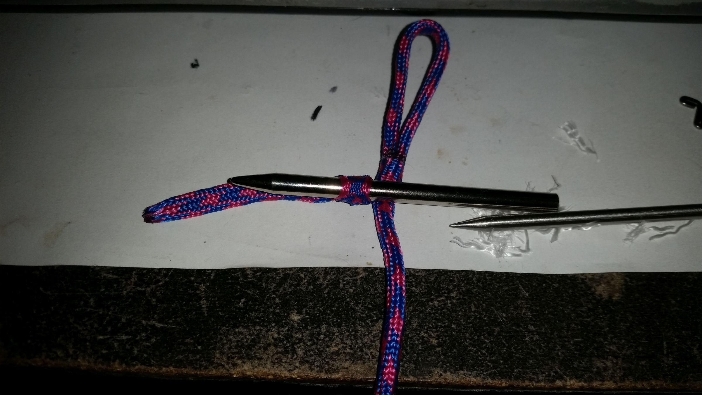

The core lines should now be fed into the long end of the sleeve where it is the straight line.
To be precise: The core lines are fed into the long sleeve after the short sleeve is pulled through the hole and aligned with the markings.
I used a hook and entered about 2cm above the max length of the core lines - that is again starting from the lock point where the core comes out.
I use a thin probe to keep the core from going in all the way.
This helps to align the markings ;)

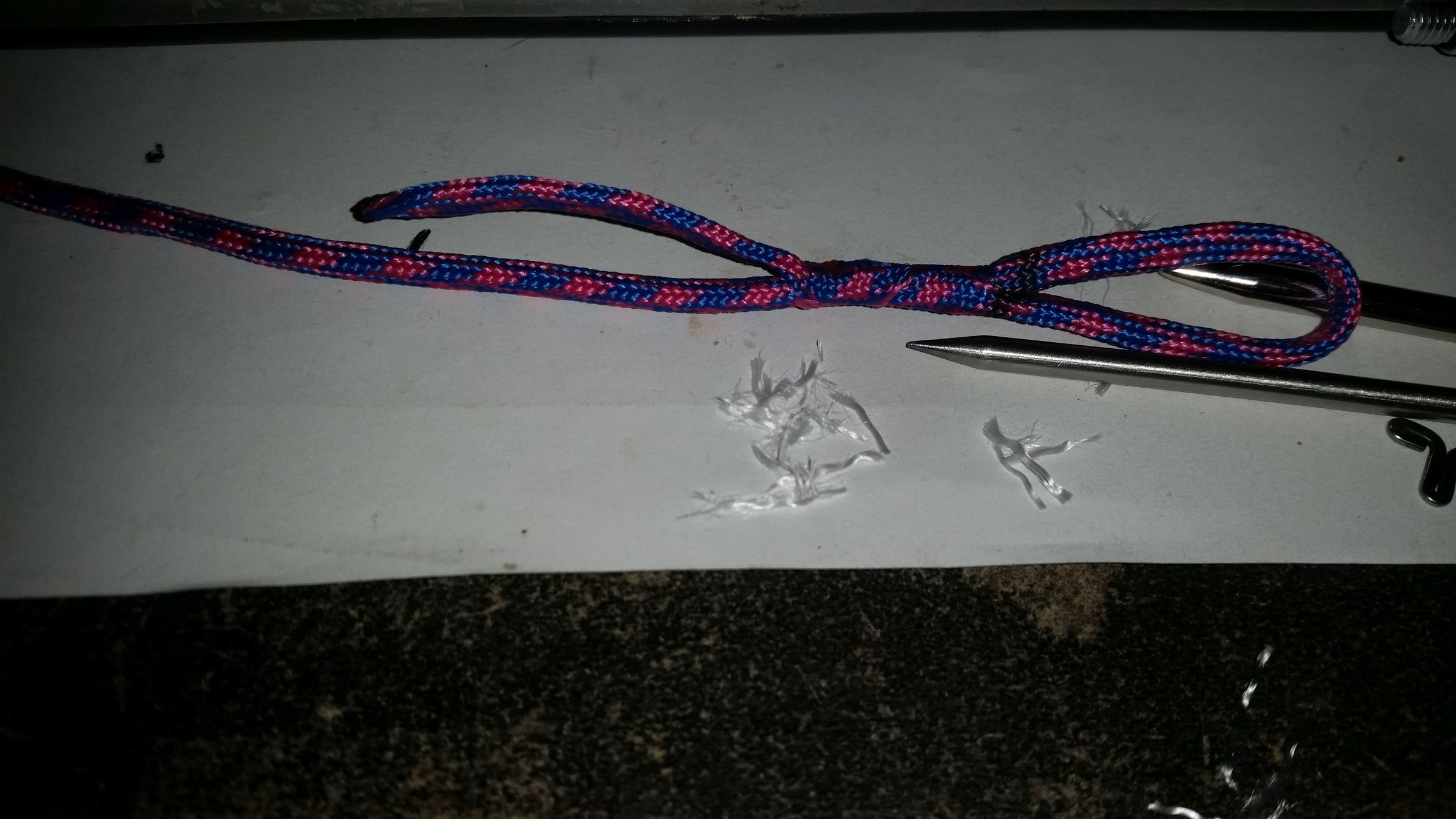

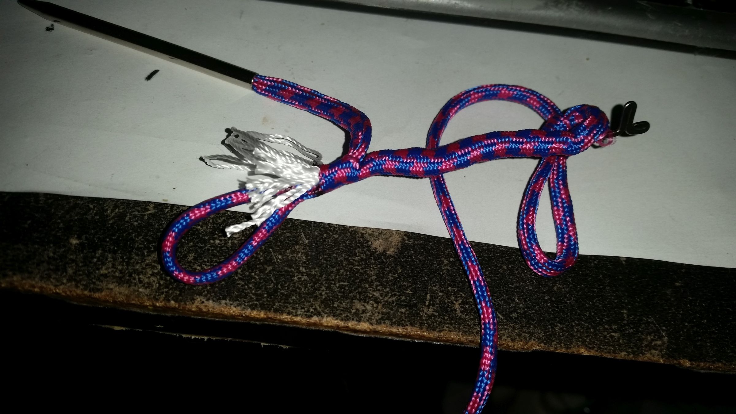

As you can see I already thinned out the core lines but the sleeve is still compressed.
You can't really see it in the pic but I actually kept the loop for the core a bit shorter than what the loop sleeve is.
The purpose of this is that we need a bit of tension on the core when we do the final steps.
When the long end of the cord is pulled through the second hole for the Brummel we feed the core lines back into the short sleeve - again make sure to align the markings.
The distance between the two locking points will disappear when we pull it all close!
I did not pull with a lot of force here, just enough to align everything properly.
Tricky bit is now to pull the core lines through while getting the sleeves to move together to form the lock.
It helps to use an anchor point for the loop so you can really pull on both sleeves and the core lines.
But first do it by hand only and only on the long end of the line and inside the loop!

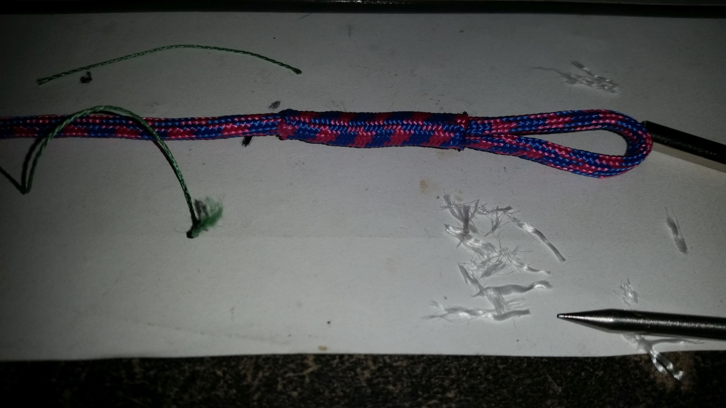

Sometimes shortening the sleeve and marking the core lines at this point also helps, at least to get a better grip on the core lines. while they are still outside, but this is again very tricky as it leaves the joint area without tension.
If the sleeve feels hard and round in the eye it means the tension is correct.
A loose and wobbly sleeve means the core is still too short inside the loop and you need to to work the loop again to stretch it all properly.
Only once the eye feel hard and tight you should get full load and pull on everything to get the sleeve to tighten around the core.
If you do it too early you will have a damn hard time getting the sleeve tight around the core of the loop/eye.

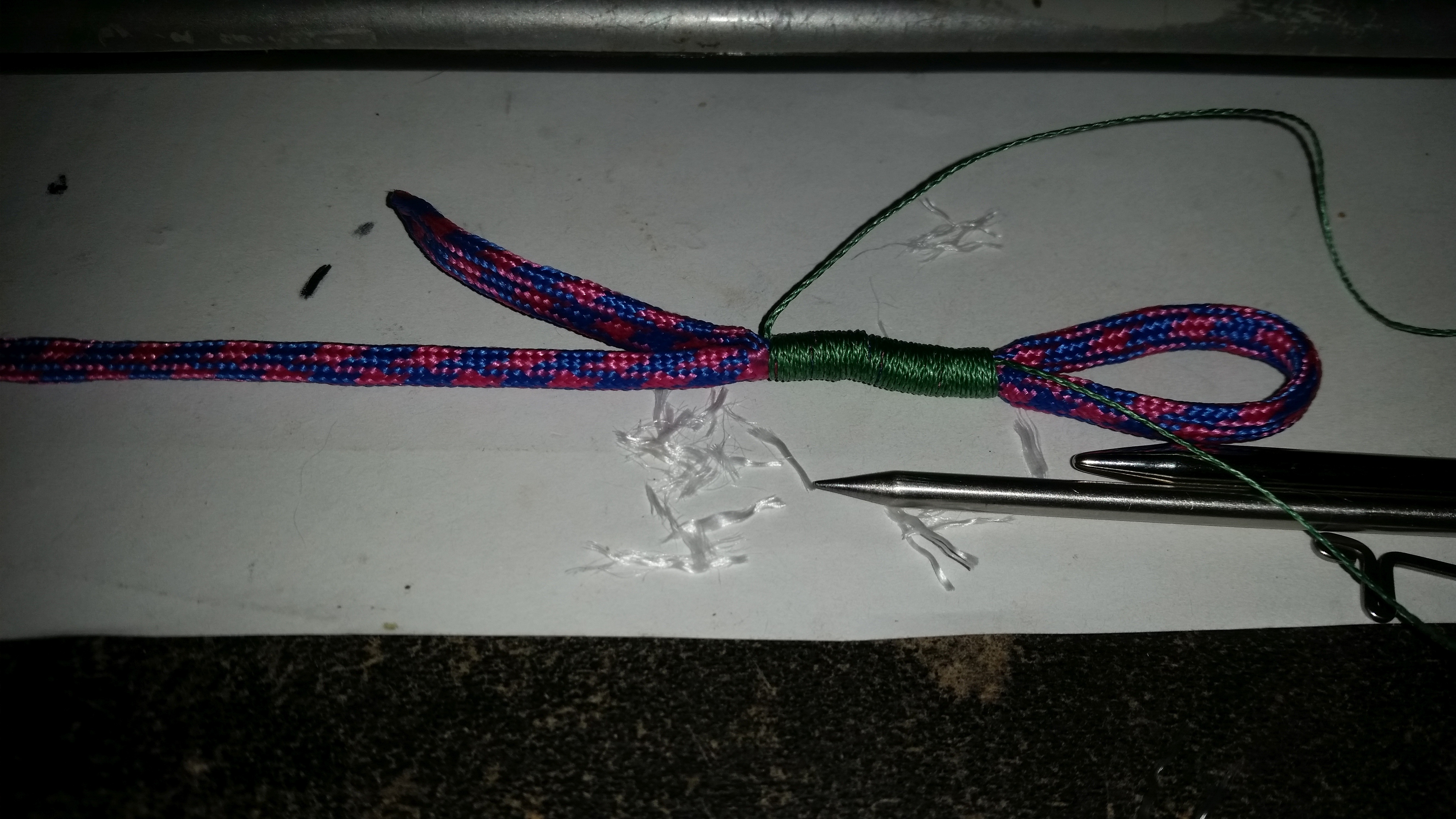

To finnish off we could feed the short sleeve back into the long end but this is a painful process.
To give added support I prefer to wrap it all with dental floss or braided fishing line.
This will compress all and provide a tight grip on the core lines.
It is also a neat way to make the eye fit perfectly onto a metal eye - you know the thing...
Loose ends cut off for a clean finnish - do not use a flame to melt the free ends as you can damage the sleeve.
If in doubt just continue the wrap until you cover all ;)
If you need really a lot of security then you can feed the long end through the entire fee short end.
If wrapped or better knotted with dental floss or braided line it gives added grip on the core lines.
Having a clean and stiff finnish often helps to work the looped end of the line, especially when wet.
Just because it was a prefect match I used the leftover from the sleeve to slide back onto the line.
Not secured or anthing, just a lose protective sleeve.
If done correctly the core lines will match up with the sleeve end, although you might not be able to see that once finnished.
If your core lines won't disappear into the sleeve it means you need to stretch the sleeve properly.
Can be tricky, which makes some practise a requirement before attempting this out in the field.
Done properly won't even decrease the load capacity here as we have two sleeves compressing the core and a Brummel lock on the sleeve.
That does not mean your first one will match this...
Working with sleeve and core on seperate levels just takes more time and more practise to get done properly.
Don't be disappointed if your first attempts here only hold 100kg, you will get better with every new eye you make!

Of course you can always improve on the joining part to avoid feeding long lines through the joint...
Doing this with ungutted line however is a whole new level and you might never have a cord too long to feed through.
If want to try something different use waxed dental floss more often.
You can even secure and stiffen the ends of your cord with it which makes feeding it through holes much easier.
And as said it is even possible to attach monofilament line to paracord or braided line without making a knot into these.

A common practise is to just cut off the core if it hangs out of the sleeve for ease of working with the cord.
Every time you do this the sleeve is getting LONGER.
So long before the sleeve stops stretching and forming a tight fit the core lines will simply stretch or break under load.
For the usually low quality and unsealed paracord I prefer to seal one end and than use thick welding gloves and a lot of force to run along the sleeve to stretch it as full as possible.
Quite often the core lines disappear here as the stuff was taken from big rolls without any attention to detail.
To prevent this you can loop the core lines out of the sleeve a bit further and cut the sleeve off.
This way you can mark the core after each stretch until it is tight.
Once done lock with some pliers or similar, clean cut and hot seal.
