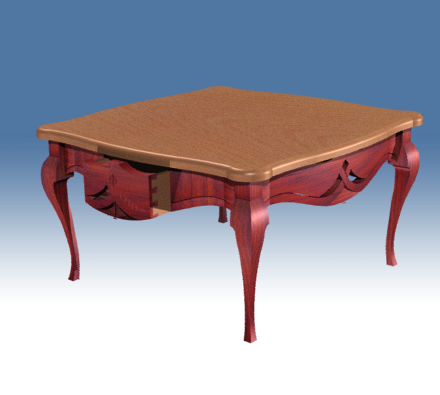

Introduction: My Masterpiece in Real!
I promised you guys pictures and how I made it. A lot is happened between my last Intructable and now.

Step 1: Buying Wood:
First I made a few changes. I was going to make the table out one kind of wood: Padoek.
-I love Padoek, it has a pop out kind of orange and has red waves in it!
-I made the table legs with the machine, not by hand. Even padoek is amazing by color, it sucks to work with!
-I made the drawer longer, so a lot of stuff to hide in! and I bought a soft close system, not a puss and pull.

To make the side's I made a mold in Iron cad, programmed in Alfacam en let the CNC machine mill it out. There are holes with a PVC in the mold so everything fits perfect. A little glue, let it dry 30 min.

First I used my model from Iron Cad and programmed it in Alfacam. I spent a lot of time on it! It was hard because I only learn 2D but not 3D. I had a little help from a professor and i´m thankful for that! I screwed the side on the mold and put it on the CNC machine and it does the rest. It was amezing. Only one mistake with the carving. I forgot a line to delete so he went a little diieper... I had a to sand it smooth but the rest is perfect! After the sanding and making it smooth again, I made the classic pin and hole connection and it was done for now! I have a video but cant show it....
