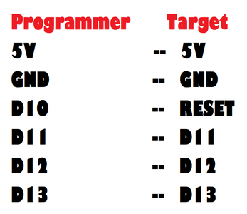

Step 4: Burning Bootloader:
To burn the bootloader the SPI pins of Arduino are used which is different from the programming serial pins. New Arduino microcontroller do not come with pre-burned bootloader. So to specify the input/output, booting menu and subroutines we have to burn the chip with any working and compatible board bootloader.
Just wire the two boards as shown in the figure above and burn the bootloader from Arduino IDE. It will take few seconds and after successful attempt give a notification.
