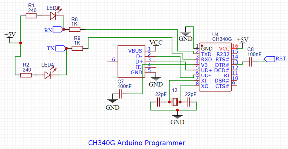

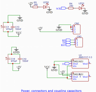

Step 3: Circuit Diagram:
I am sharing the proper schematics with you, In the first image you can see microcontroller section, then programmer chip section and power section. You can also Download full PDF of this circuit from here.

Step 5: Circuit Description:
The most challenging thing is to keep the cost as low as possible, so we tried to go with ch340 programmer chip, which is directly connected to USB and known as USB to serial chip. RX and TX pin is connected to MCU with a 1k resistors and DTR pin to reset with 100nf capacitors. To give a proper clock signal to MCU a 16MHz SMD rasonator is there. Ch340C is used as USB to serial programmer has inbuild 12MHZ crystal for clock. Reset pin is connected to 5v with 10k resistor and pulled down whenever we have to reset the programmer. Some capacitors are used to reduce the noise in signals and There are 4 indicating led's for RX, TX, Power and D13.

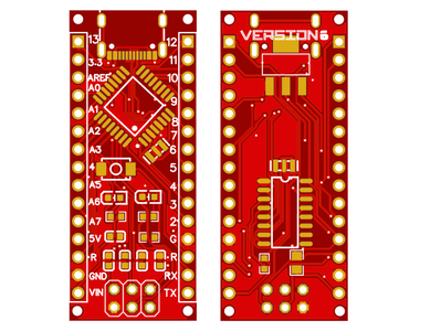

Step 6: PCB Layout and Ordering:
I want to make the exact same form factor PCB as Arduino Nano. So, I designed the PCB keeping the pins and voltage in mind. Download my Gerber files from here.

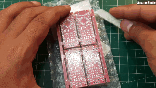

Step 7: Soldering and Assembling:
Because I want these PCBs for my college students, I am using paneled PCB. So, that we can make more microcontroller boards in less time.
Step 8: Assembly:
I ordered the stencil also from PCBway, the full review to it is here. both top and bottom layer is printed on this single stencil.

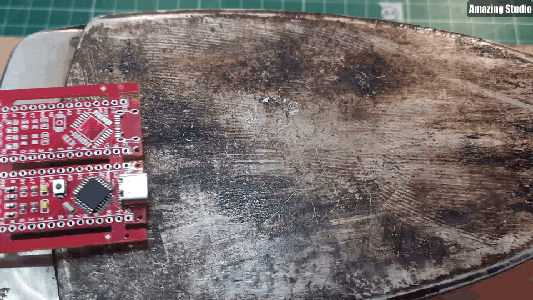

Step 9: Soldering:
Then I placed all the components and this is the time to solder. Because I don't have any hot plate, my home made Iron can do the job. As per bottom layer hot air gun is the best method to solder.
