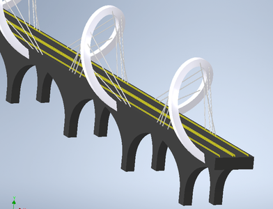

Above, I have some images of my bridge in different views, some close up and one far view to demonstrate the size of this bridge.

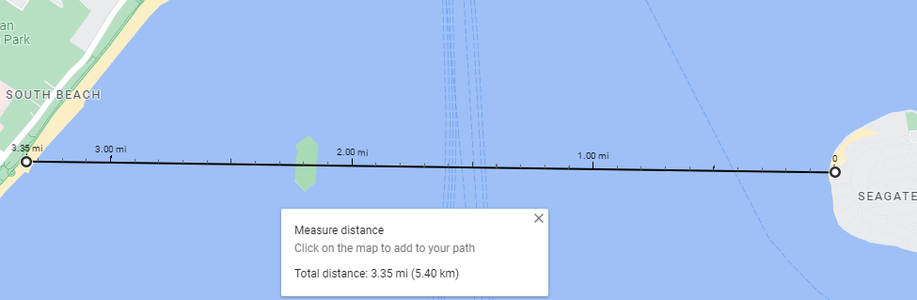

This was also a convenient time to measure some dimensions. I used google maps to measure the distance between Seagate and South Beach, which was approximately 3.35 miles. For the height and width dimensions, I researched the average for both dimensions but changed them accordingly throughout my project to fit the bridge's proportions.

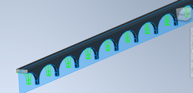

After an extrusion of 906.6875 inches, I built the arch beams that would support it as every bridge needed support underneath. I created a plane using the lengthier side of the bridge base and created a sketch of it. The idea was to build 1 side of the arch beams and mirror it, saving me time. I created the arch beams using an ellipse or an oval and cut them in half, resulting in the arch shape. I then had to copy and paste the arches using the copy command. This was where I had to do some adjusting of the length as the arches were not corresponding with the ends. Another extrusion later, I was one step closer to finishing my body. Lastly, it was time to mirror the planes using the another plane in the middle of those two.

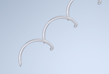

The spirals were the main design for my bridge. This was surprisingly the easiest part out of all. I figured out I could use the coil command as the design is very similar to the spirals I was looking for on my bridge. After 1-2 YouTube videos, I figure out how to use coil. I had one problem with the coil, and it was that the coil command made an entire loop around and my bridge doesn’t require the entire circle loop. I figure out how to solve that problem by using the dimensions of my bridge base and extruding cutting a gap between the spirals so my bridge base can fit perfectly in between.

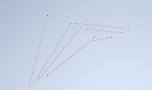

The third part file required was the suspensions, and this was arguably the hardest part of the project.
I had to make planes at an angle so that they would fit between the base of the bridge and the spirals as to the support. It got easier after a while due to me just creating one suspension and using the rectangular pattern command for the rest saving me some time. Each suspension took very long due to them being at different angles and it ultimately was the most annoying and time consuming part of this project. In the end, I settled for 7 suspensions per spiral, 4 towards the inside, and 3 towards the outside.

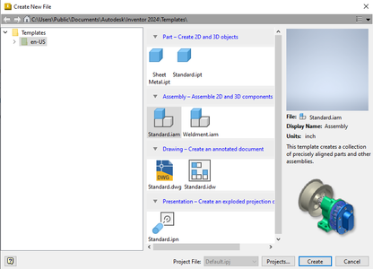

To assemble the part files I had to first place them all together in one file and constrain them. There were different kinds of constraints, but the ones I used were mate and flush. These constraints required a face from each file so it could be constrained.
