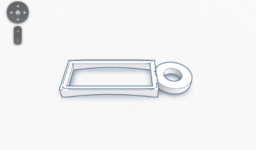

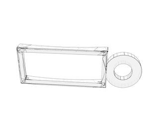

I measured my STRIIV without the band attached. It's designed with a curvy bottom because I wanted a contoured look. You can get a little creative when you design the hole for your safety pin. Because there is a flat edge you can connect shapes. I selected a circle I thought that would give my safety pin room to move. If you decide on another shape, you will have to put a hole through your shape for the safety pin.
For this project I used a combination of applications:
- TinkerCAD (very easy to use if you don't have experience using CAD applications)
- Fusion 360
- NetFab (Free Version)
