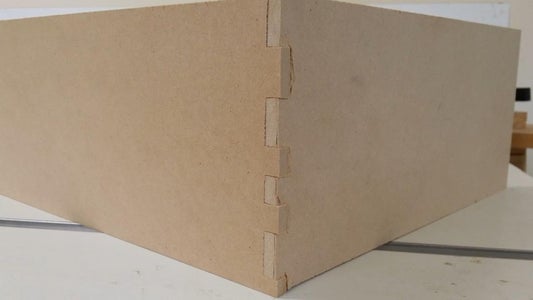

The results are great, perfect fitting box joints straight off of the tablesaw. I think this may be a really helpful jig for a lot of woodworkers like myself who have no dado set, but still want to create strong joints on the tablesaw very quickly.

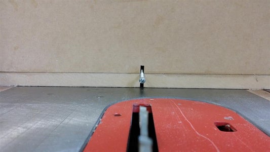

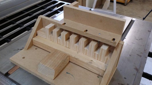

How does it work? By having your work pieces clamp to a sliding fence which follows a cutting template. You make your cut, slide the fence over and make another cut. A ‘key’ limits the range of movement based on the cutting template you have setup.
Mine was made from scrap MDF, a short 2×4 offcut, and a small length of 19mm (3/4in) pine for the building blocks. It took just over an hour to make and cost me nothing, I had enough scraps on hand. It’s saved me a huge amount of time and money already; I’ve put together a dozen drawers with it and a few boxes, faster than ever before, and I didn’t have to use a single screw or purchase a dado stack to do so!

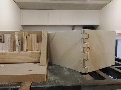

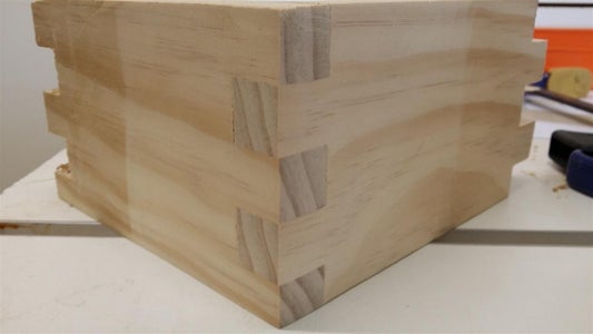

All from the same jig with no difference in setup time!
You can mix and match your finger widths to create different effects, these would look wonderful in nice contrasting hardwoods. Not so pretty in 6mm MDF or cheap Plywood but it was literally all I had on hand I'm sorry!
