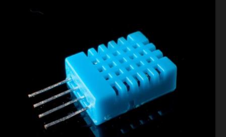

Humidity sensor: Overall these are pretty common and easy to purchase, I just needed to do some background research regarding what this sensor needs, its programs and more.
Something to pay attention to: Looking close into the Humidity sensor, I acknowledged that the whole arduino would now have to be placed INSIDE of my terrarium which wasn’t a bit issue but there was water particles in the air and at the bottom of the tank which showed me I need to be very careful when placing electronic components inside.

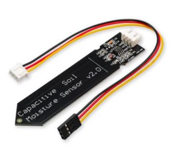

Blue wire was connected to 5V and connected straight to one end of the resistor and one leg of the Moisture sensor(white square).
Yellow wire was placed to connect the other side of their resistor to the Moisture sensor(white Square). Which completed the used of the 10K resistor
It is clear that the orangish tan wire is mainly for connection from ground to arduino to make that complete connection.
The green wire is connected from port 13 to one of the legs of the red LED light. While the Purple Wire is connecting from port 9 to one of the legs of the green LED.
The white wire is connected to another resistor which is in like with the red LED notifying it when the Moisture Sensor is going off.
Orange pin form A0: This pin gives a variable voltage that corresponds to the moisture level in the soil—the wetter the soil, the lower the output voltage.
