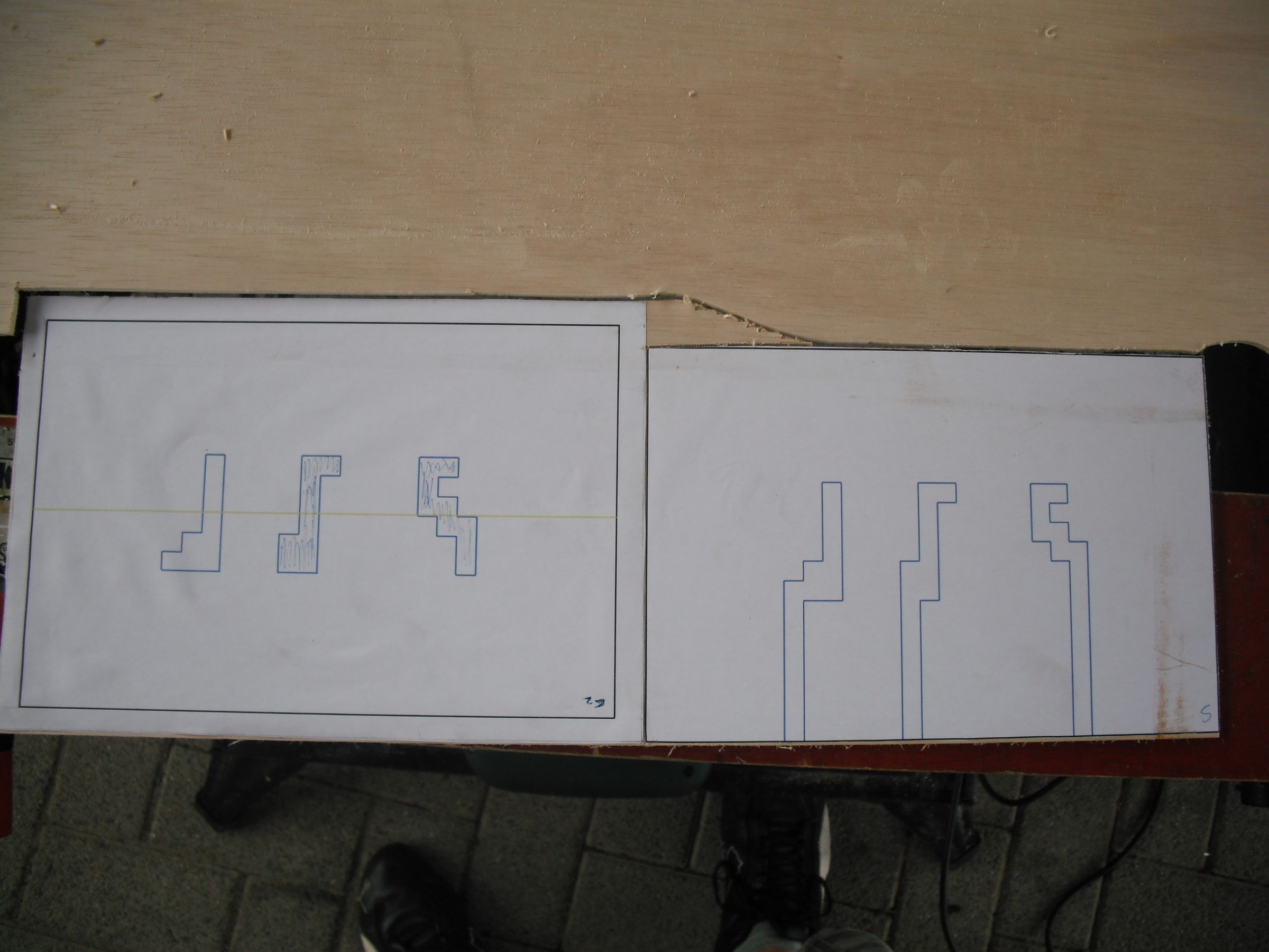

Step 3: Layers Into Depth
Sides of a box
A box most likely has 6 sides, of wich if you're using 1 locking sides you have 3 or 4 fixed sides and have 1 or 2 lids. Fixed sides normally simply consist out of 1 layer and are glued to the other fixed sides so they can't move. Lids can normally come all the way off or be a fake. These sides normally rest on rails look at the image. Then you have the locking side this side can consist out of 3 layers (it's possible) but this give a lot of limitations especially if the box is quite small. Normally it consist out of 4 layers or 5, you use that fifth layer to make it stronger and cover up the keyways on the inside.
(see the first picture on this page)
Sliders
Normally these are used to guide your your round pin trough the keyway. In the less moves(most likely easier) boxes there is probably one slider on 1 side, and then as the moves go, 1 slider on 2 sides, 2 sliders on 2 sides, 3 slider on 2 sides and then 4, etc.
Sometimes the whole side panel is used as a slider . But when making slider you have to keep a few things in mind. Sliders have to be attached to the panel someway, so they can't move up or down alone, nor can be pulled out or off. This can be done in several ways (see picture 2 and 3). Also keep in mind that the parts from the slider that are between walls of the box need enough space to move to the right and left. If you have mutiple sliders make sure that the keyways are so that if you move your sliders the right way they always have enough space to make the right move.
Step 4: Keyways
What are keyways? keyways are like mazes, only if the right way is taken you'll get out.
Keyways can be made in a lot of different ways, but the most usual is to make it so that a round pin has to be guided trough. Simpler and easier puzzle boxes have progressive keyways meaning every next move is the right move. harder puzzle boxes have dead ends in their keyways.
Keyways also determine partially the amount of moves (like 50% to 100%) but its important that if you wanna make a box with alot of moves, to keep in mind that by just making 1 or 2 keyways and 1 slider per keyway it's not becoming that much harder nor more fun.
A good amount of move Per Keyway should be between 5 and 15 (note this is just a guideline).
It's much more fun and harder to use 2 or 4 sliders per locking side.
