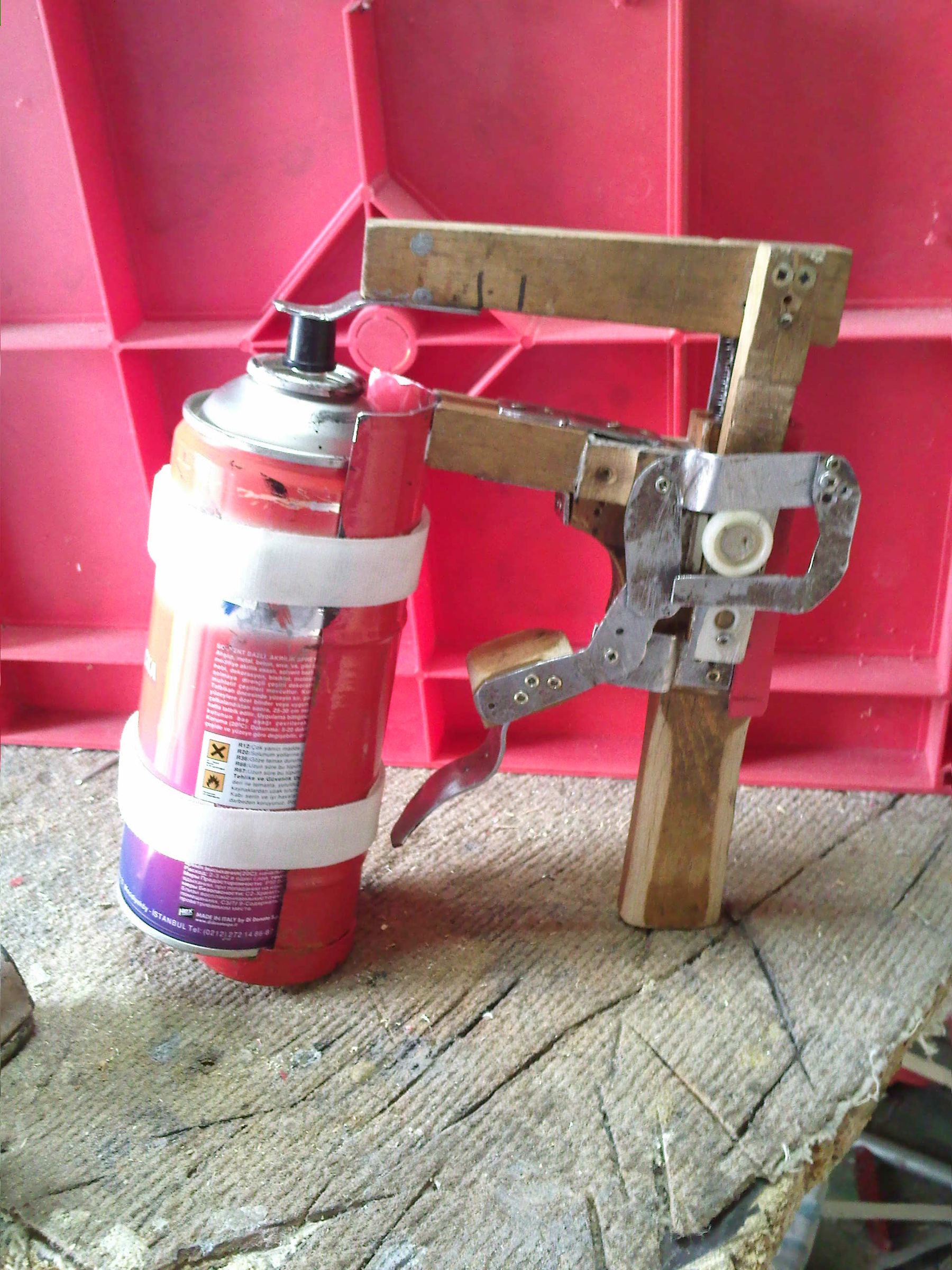

As for the paint job after several attempts made in the decision to spray paint effect HAMMERITE hammered ... it's too late (1 day) I prefer to be dry and durable despite not showing an error ... hiding power in a super ...
Also notice that the stained tissues have small pits .. it must have been hammered effect! ... The paint on the chassis adds an authenticity to the mediocrity of paint instead of a
This hammered .. It is able to distinguish the effect that corruption and other parts! .. At a time (remote) paint, I need to finish ... I was on this issue but not a problem in some mistakes ...
