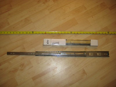

I purchased these a pair of these at my local Home Depot, they cost  less than $20.  They come with 12 screws, I'd suggest picking up a little bag of #6 X 1/2 screws as well.  The more points you mount the hardware, the less likely something is to pull apart.
I went with the 16" length set, kind of wish I got the 18" but they were out of stock.  Oh well.

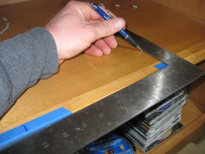

I put down some tape on the edges of the shelf and found the center.  I double checked my center mark by measuring from the left side of the opening and right side of the opening to make sure both measurements were the same to the middle mark.  Then I took my square and marked out 10" away from the center point.
I placed the sliders down and made sure everything looked good.
