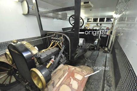

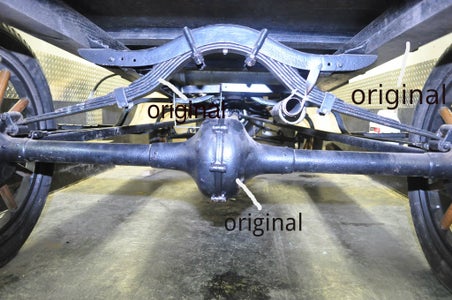

here is my newest project. a model t he hasn't been out of the trailer since I got him ( his name is henry) but I know the engine isn't seized. there is no water in the radiator and he has a crank on the front. the guy I got him from was about 2/3 the way through restoring him so he is all nice and painted and the engine has been taken apart and cleaned I cant wait till I get the time to take him out. the windshield piece is original the wood support running the length of the truck is original and most all the metal pieces like the fenders and the metal support running from the engine all the way back is also original . I would appreciate any advice that would be given.

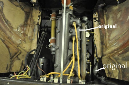

we struggled with this a little and still are not certain of the year. we think its is around 20-23 because the frame has no serial # which they started putting on in 1924.the engine serial # is the one in the photo. we think the # before the 6 is possible a 3 or 5 and before that we couldn't see.

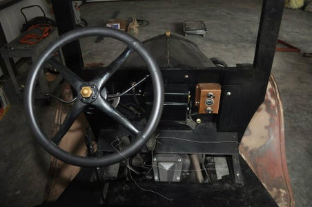

here are some pictures now that its out of the trailer. so far I have taken the starter out and kind of tested it. so before I said it did work but we tried again and it doesn't. the carburetor also needs to be re-built so eventually I will do that. right now its just sitting in our workshop waiting for parts.
Step 3: Starting
we got the carburetor and replaced that. the problem with the starter was we didn't have a good ground, so we fixed that. after all this we put some gas in the tank and turned it over a few times and he started right up. the next day we took him out of the workshop and started him up again to drive. the only other problem we ran into was an oil leak at the front end. after that is fixed we will enter him in parades and things like that.
