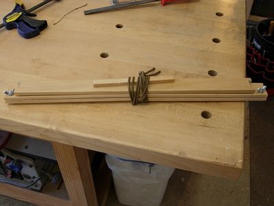

This my version of a folding camp saw, used to cut fire wood or whatever, just don't cut yourself. See the saw used in a test cut video cutting a 3 1/2" walnut log. This is very hard wood and the saw worked very well.
Also see the video showing how to unfold and fold the saw. It took just over 2 minutes to unfold and refold the saw.
I'm not going to claim this idea for my self. I saw different versions of this on Youtube and on this site, this is just the way I did mine.
This saw weighed less than 12.5 oz. and about 20" long. That's small enough to easily fit into any pack. It weighs less than the garden saw that I started with, and it folds.

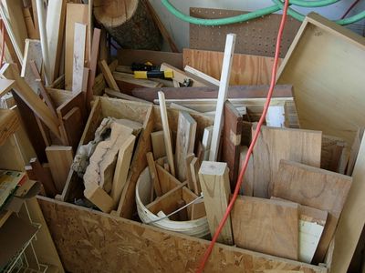

Again, this is a prototype. It's made of pine scraps that I had in the scrap bin. I plan to make a more durable one out of some walnut or cherry the I have on hand.
The only thing that I had to buy was the garden saw. It was cheaper to buy the whole saw than to buy just the blade online with shipping and everything.

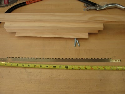

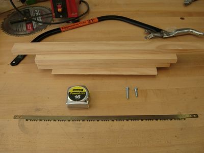

Material:
  1. Blade from store bought saw.
  2. 1 1/2" pine scraps. 2 @ 10". 1@ 20"
  3. 2 bolts sized to fit through holes in blade, with nuts.
  4. 1 piece of paracord about 40" long. (Not pictured.)
  5. Small toggle stick for torsion cord.
Tools:

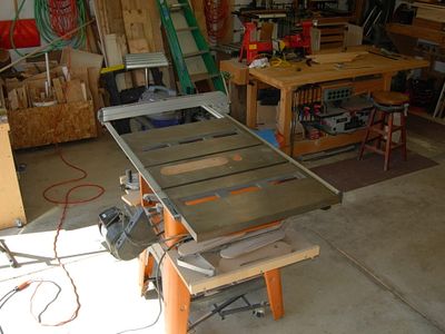

  1. Table saw.
  2. Drill.
  3. Router table.
  4. Measuring tape.
  5. 1/8" Roundover router bit.

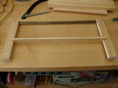

Measure the blade to give you an idea of how long to cut the handles that will fold over the blade when closed. They can be a little long and trimmed for an exact fit as you go along.
So, for a 21" blade and 2 handles, 21 / 2 =10 1/2".
Cross piece ended up being a piece I found in the parts bin that was about 3/8" thick and about 1 1/2" wide. saw is about 21" long so cross brace is rough cut at 21", all to be fine tuned as we go.
Torsion stick is any small stick that you have around, even something picked up off the ground.
Rope for my saw is paracord, very strong. You can use any rope that is strong enough to handle the pressure that will be put on it to get the saw blade tight enough. It does take quite a bit of tension to do this. You could ues wire if you aren't going to take the saw apart very often.

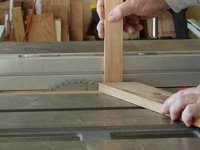

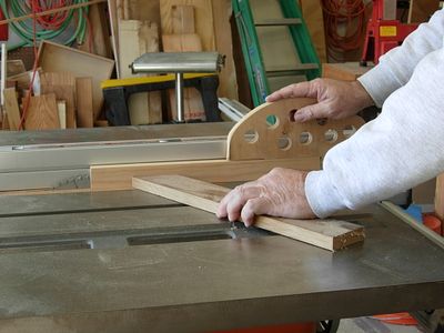

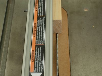

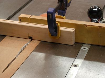

First we're going to rip a slot down the length of both handles.
Set the tables saw fence so that the blade is centered on the handle.

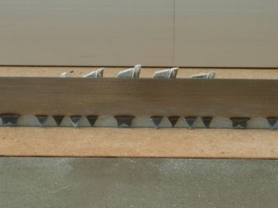

Now set the height of the table saw blade is just a little higher than the width of the blade for our new saw. we'll use the new blade as a gauge for setting the table saw. Make sure the table saw is unplugged for this step and every step that brings fingers close to the table saw blade.
Now that that's done, we'll use a push board and a feather board to run a scrap test piece through our setup to make sure we like it before cutting our handles. If we like it ,we cut the handles, otherwise make adjustments as needed then test again.
Next is a slot in the end of the handle so that the handle can fold over the blade. One end only. I used the same set-up as the other slot and it worked ok.

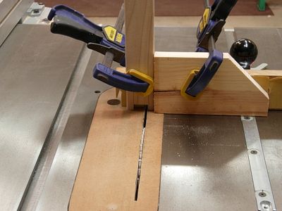

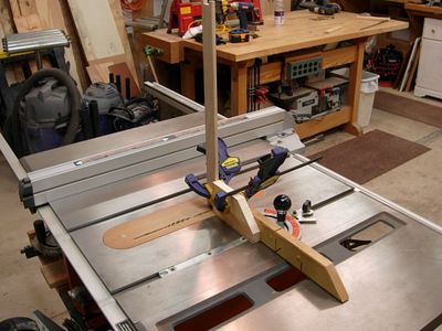

The last thing needed is a notch for the cross bar to nest in. This gives the cross bar a nice solid fit.
There in no precise way that this needs to be done. I used a notch about 3/8" deep and the same width as the cross bar is thick. The notch is about centered. It can't be to far up on the handle of you wont be able to get enough leverage with the tension rope to get the blade tight enough to keep it from bending and binding.
Set table saw blade at desired height, clamp pieces to miter gauge, make one cut, move pieces over a little bit, re-clamp, cut again. Repeat until you reach the other mark, now you have both pieces cut at the same time. Saves time.

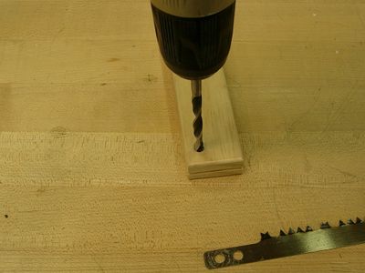

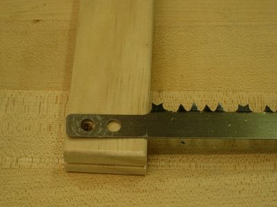

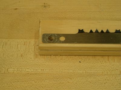

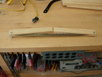

One hole is needed in each handle for mounting handle to blade.
To find out where the hole is positioned, I laid the blade on top of the handle in the closed position, marking the center.
Then I laid the blade on the handle in the open position, again marking the center.
It might be a good idea to do this on a test piece before drilling the real handle. You should have a test piece with slots cut in it from testing the slot cut. After marking, drill hole that matches hole in blade. mount blade on test piece, swivel open and closed. If you like the fit drill real handles, one hole in each, and mount on blade with appropriate sized bolts.

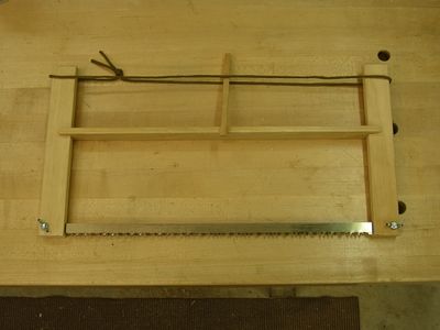

Now that we have the handles made and mounted, we're going to make a cross brace, or spreader bar, same thing.
For this piece I used the same table saw set-up that I used for the notch in the handles.
The width of the notch is the same as the thickness as the thickness as the handles, and the notch is centered on the cross bar.
The process is basically the same as the notch on the handles. For this step I clamped a scrap block to the miter gauge to help keep the cross brace upright and square, cut on the first mark, move piece and block a little bit, repeat untilo reaching the other mark.
Flip piece end for end, and repeat process on other end.
Test fit the pieces, make any adjustments if needed, and we are almost finished.

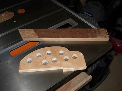

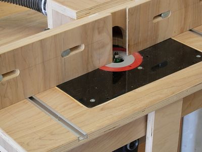

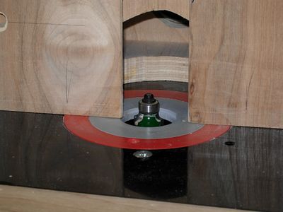

Step 6: Roundover All Edges.
This step is not necessary, but makes the handles easier on the hands, and helps keep the corners from splintering. This can also be done with a piece of sand paper wrapped around a scrap block. All we need to do is ease the sharpness off of all the corners.
I used a router table with a 1/8" roundover bit because I have the toys so I get to play with them!
You can see the rounded edges in the last picture.

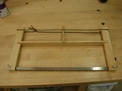

Step 7: Put It Together.
Tie the rope loosely around top of handles, then use small stick to twist rope to tension blade. Stick catches behind cross brace to keep it from unwinding.

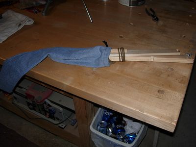

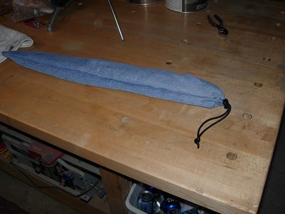

Step 8: First Revision.
After using this saw a few times, I decided that a carrying bag of some sort was needed. So, after seconds and seconds of hard thought, I came up with this.

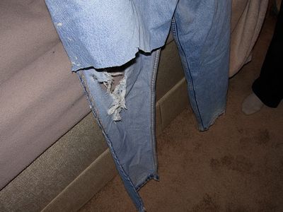

I don't know why I keep these old jeans around, but this time I'm glad I did.
Giving credit where credit is due Mrs. Str8shter did all of the sewing work on this, I just stupidvised.
This is fairly straight forward.

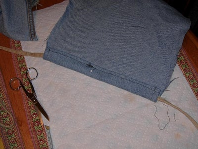

First, cut as large of a piece of fabric as possible out of the back of the leg of the old jeans.

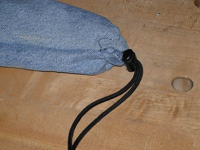

Then, sew tube for draw string.
Next, seam the remaining sided to close up the bag.
Use.
