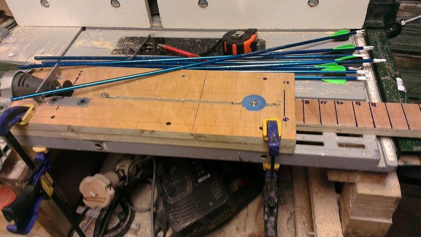

Step 2: Starting the Top
The laminates are 1380mm long and a fraction under 190mm wide. I cut the first two at 1000mm for the table top. The offcuts would form the crossbracing
Step 3: Making the Table Top
I found the centre of the plank (500mm) and then offered up the saw. I lined up the centre bolt with the centre mark and then marked out the extents of the blade mechanism. This material was then removed with a tenon saw. My jigsaw is in storage with most of my other shop tools but I think the tenon saw did a better job.
When the piece was removed I offered up the second top plank to mark out how much needed rebating off it to allow the blade to sit down. Finally the saw is in place
Step 4: Laminating the Tabletop
Now that the slot is finished I ran a bead of glue down the groove of the laminate. I don't want it coming apart. The offcuts return to the fray. They are just the right size to act as cross bracing and being perfectly square, they will additionally aid the correct alignment of the saw. I used instant grab glue to fix them ready for screwing but due to the sub zero (celsius) temperatures the glue wasn't playing, so I clamped them with some scrap wood. Finally for this stage I cut some infill pieces and glued them in place
Step 5: Laminating the Tabletop Pt2
Now onto the final layer for the table top. This is the bottom but you get my drift. This piece will run in the same direction as the top and has the cut out for the face plate of the saw. When the recess is removed from both pieces and after a dry run to ensure they fit. It is all glued and clamped up. the table top is now 20mm thick and very sturdy but the next step will stiffen it further.
