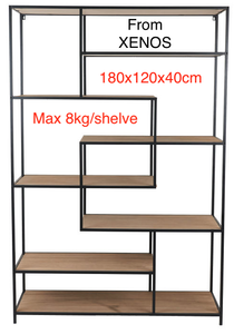

This part is easy. My partner found a shelving unit that was offered in an online store that happened to have a branch nearby (smart move from her). Click here for more information or check the corresponding picture.
We went to the shop to check it out and it felt so flimsy, made of thin-squared steel beams for the structure, fake wood for the shelves and you had to attach it to the wall! I did not really like the idea and I could see that "thing" getting rusty in no time. But the design layout was something.
And yes, it happened again, my imagination started working out the same idea but using "better" materials, with conventional tools. And without even checking if I could make it possible, I ended up telling her that I could create the same, with our desired measurements, with REAL wood and cheaper (I am going to regret that). I took the challenge...my first piece of furniture!
Once more, I fell into a black hole. Actually, it is always the same one. I am sure you know what I am talking about.
