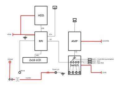

Step 1: The High Level Project
based on the requirements I've buiil a schematic of what needs to be done and made my hardware/software selection :
- RPI with Volumio as it is light and simple. - no aquisitons need to be done
- DAC with IR receiver to be able to control the system with a IR remote control and comply with requirements - to be aquired
- 2x16 Character LCD for headless system control interface. Need USB interface as I dont want to solder anything on top of DAC - to be aquired
- Remote control - Reused one from apple TV that is barely used.
- Class D amplifier - to be aqquired
- Input switch - Reuse a broken one with four inputs. Use the 3P4T switch with custom cabling and the power unit to power 4 status leds. Add extra led for power on signal. - no aquisition needed
- On/Off Switch - Reuse some 220AC with red button power switches that I have available - No aquisition needed.
- 250Gb USB Hard disk - No need to aqquire
- USB powered hub - No need to be aqquired
- WIFI dongle - Available
- Ethernet extension cable to connect RPI to back panel - Available
- HDMI extension cable to connect RPI to back panel - need to aqquire
- 2 Power transformers - 1x12Vdc & 1x5Vdc
- 2 AC plugs
- electrical cable for AC power
- wires from old UTP cable for internal connections
- Some custom adaptations to mount the input switch in the case and volume control from a D-shape's to 6mm knobs...
- Other custom adaptations to fix everything inside the case...

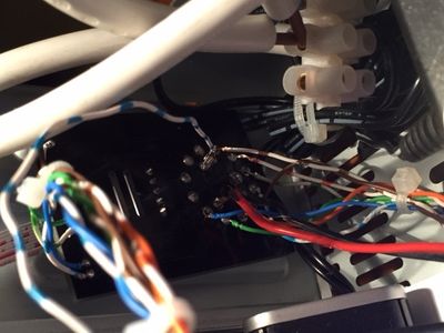

Step 2: The Low Level Project
After defining and collecting all the hardware pieces, it came the time to put everything together.
As this project is performed on my available time, it took me just to assemble everything inside the box a couple of months, because most of the work was performed during weekends and late in the evening...but it worth it...
first of all, and based on High Level Plan, I've defined the input selector part, just for understanding how to wire the 3P4T selector. I've wired Right and Left Channel and the 12VDC. For the first 2 same ground was shared and for 12VDC the reference was also shared.
The 3P4T selector color scheme is the same as wires used.
After that I've draw the overall schematic and build the system based on that... Some pictures highlight some of the adaptations done...
Build is like everything. Just do your best...with what you have

UI screens and workflows are represented on attached diagram.
check the python script in the attachments
