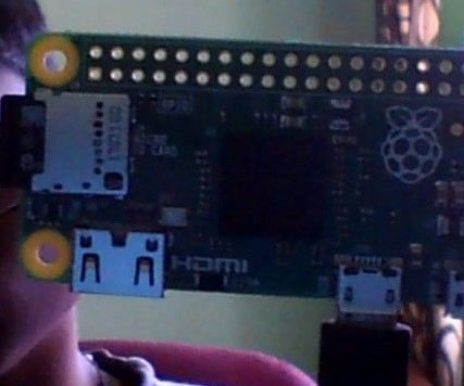

For this project I am using a Raspberry Pi Zero because it is small and cheap It can easily fit into your pocket. So your software travels along with you. But you can use any computer of your choice, as long as it is Debian Linux based.
