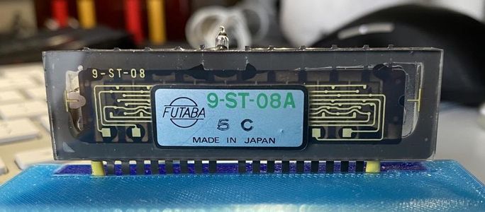

Last year, I got an old Sharp EL-8109 calculator using a 9-digit Futaba 9-ST-08A VFD display. The calculator still works, but the shell is in bad shape, making it worth almost nothing. So I decided to use the screen inside to make something useful and look good. This device supports date/time, weather, random number generator, etc.

The screen 9-ST-08A was used in a variety of calculators around the 1970s, like Sanyo CX-8032 or Unisonic 1040. The company Futaba (双葉電子工業株式会社) was Founded in 1948, making vacuum tubes and related things. They produced VFD screens until the end of 2021. Now they are moving on to newer display technologies.

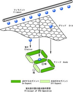

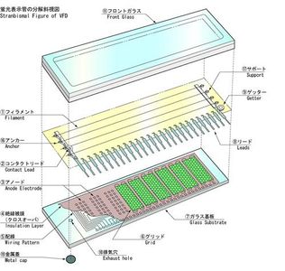

This screen is too old, so it's almost impossible to find the datasheet. But most VFD screens are using the same structure. We can find out the pinout by ourselves.
This image from Futaba's website shows the basic structure of a VFD screen.
VFD screens are very similar to vacuum tubes. Mainly, we have filaments, grids, and anodes. Filaments are very thin wires. They provide heat and a negative charge to the system. Anodes and grids provide high-voltage positive change. Electrons will fly from filaments, pass the grids, and hit the anodes when they are both powered. Then you can see the beautiful green light from the phosphor.
On a VFD screen. The pins on both sides are typically filament pins. They require a voltage of around 3V. And because we need a negative charge on the filament, the side near the positive pin will look dim. So it's best to power it with AC. This can ensure the screen lights evenly and extend its life. I'm using a square wave as the AC power for the filament. First, I generate a 50% PWM signal from a pin. Then use a NOT gate to generate an inverted signal. Feed both signals to an H-bridge, there so we can have a square wave from about +5V to -5V.
When you add voltage to the pin, you should keep eye on the filament wires. If they start to glow, turn down the voltage immediately. Otherwise, the wires can start to melt and break.
After wiring the filament properly, we can start to take a look at other pins. Anodes and grids require a relatively high voltage. To provide this voltage, you need a step-up DC/DC converter. Connect the converter to the same ground as the filament, and use the high voltage to probe the pins. You need to connect both an anode pin and a grid pin to turn one segment on. Since I have a small screen that doesn't require such a high voltage to just light, I can use 5V for probing.
By probing you will know which pin is connected to which part of the screen. You can also check if there is a schematic printed behind the screen, like the image above.
