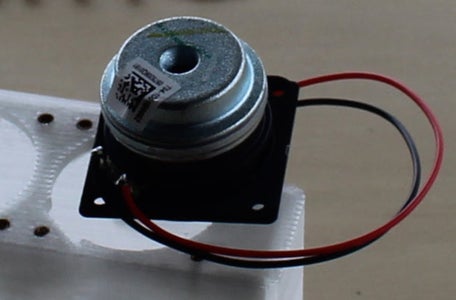

It is helpful to label the speaker wires "left" and "right" using a small permanent marker.
The small slots in the speaker enclosure are intended to allow the soldered speaker connectors to pass through the hole. Align the speakers so that the solder joints pass through the hole.
Insert the speaker drivers into the audio chamber and fish the wires through the speaker wire hole.
Secure the speakers with 8x 2.5mm x 10mm stainless steel pan head screws.
Add the speaker holder clip and secure the clip to the speaker wire hole making sure that one wire runs on either side of the clip's tab.
Secure the speaker holder clip with 2x 2.5mm x 10mm stainless steel pan head screws.
If you received a Dev Kit after August 23, 2021 it will come with a 3D printed adapter and two gaskets to assemble on the front of the speaker enclosure. The reason for the adapter is that the speaker drivers are from a different manufacturer and the fit is very tight in the original speaker enclosure. Apply the adhesive backed gasket to the face of the speaker enclosure. Apply the other gasket to the face of the adapter. The goal is to create a sealed envelope for the speaker enclosure. Next secure the speakers with longer 8x 2.5mm x 20mm screws. The screws will go through the adapter and into the threaded inserts on the speaker enclosure.
NOTE: If you have a hot glue gun you can use a small dab of hot glue to seal the wires to the tab. This makes the audio chamber air tight and may ( slightly ) improve sound quality.

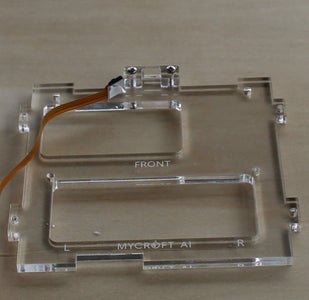

Step 5: Assemble Camera and Screen
Clean off the top tab of the front panel with the provided alcohol wipe.
Install the alignment bracket to the front side of the panel with two 2.5mm x 10mm stainless steel pan head screws.
Remove the adhesive backing from the camera and firmly press into the alignment slot.

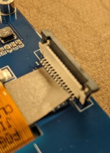

The DSI cable is a ribbon cable with conducting pins on one side. We use them to connect video devices ( cameras and screens ) to the Pi. The cable sends both the video signal and the power to the screen.
Connect the DSI cable with the conductors ( shiny part ) oriented as shown. GENTLY! pull out the arms of the DSI connector, slide the DSI cable into it and GENTLY push the arms back down
Remove the orange adhesive cover from the threaded posts on the back of the touch screen.
Orient the screen face down and align the acrylic front as shown. Route the cables as shown and secure the screen to the front using four 2.5mm x 10mm stainless steel pan head screws.

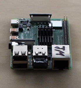

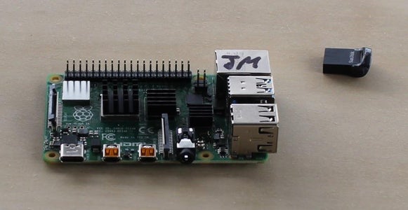

Step 6: Prepare the Raspberry Pi
One at a time, remove the adhesive backing from the three heat sinks and install them on the processor, ram and USB chips on the Raspberry Pi.

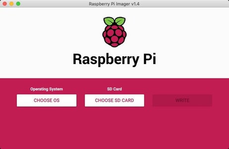

Step 7: Flash Image Onto USB Drive
Hopefully you started downloading the Mark II software image at the beginning of these instructions.
If not, please take a moment to download the image now.
Windows/MacOS/Ubuntu
If you are using Windows, MacOS or Ubuntu use the Raspberry Pi Imager to flash the custom image you downloaded onto the provided USB drive.
NOTE: You must choose the "Use Custom" option and select the image you downloaded.

Step 8: Insert USB Drive
Now that you've flashed the image onto the USB drive, insert it as shown.
