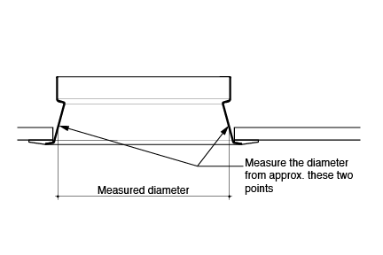

Step 1: Measure Inside Diameter of Light Fixture's Trim Ring

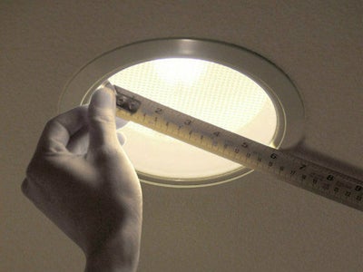

Your recessed ceiling light has an outer trim ring, and the mylar light diffuser will be fitted into the inside of this ring, so we'll need to measure its inner diameter.
With a tape measure or ruler, measure the inside diameter.
There may be some variability in your measuring as the inner walls of your trim ring may be sloped, making it tough to make take a very precise measurement. But it's not crucial to get a super-precise number, so just determine a reasonably accurate number.

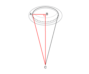

Using the diameter you measured in Step 1, refer to the following diagram to calculate the length |AC| of the triangle ABC.
The length |AC| can be calculated from this formula below, with the following givens:
- BC is the radius (equals the diameter you measured in Step 1, divided by 2)
- AB is the desired height of the cone (choose a cone height you think you'll like)
|AC|² = |AB|² + |BC|²
Here's an example use of this formula. Assuming a ceiling light diameter of 5.5" and cone height of 13", the math would look like this:
|AC|² = |2.75|² + |13|²
|AC|² = 7.5625" + 169"
AC = 13.29"
