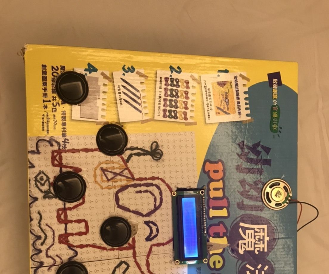

Step 4: Painting an Box for Your Light
As above.
You can decorate your box and paint different regions for different light condition
