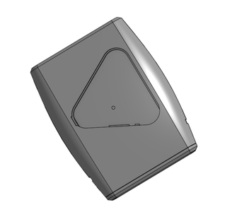

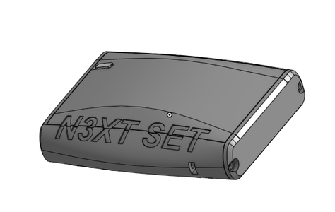

Step 2: Case Design
The case was custom designed for this setup and to facilitate ease of taking it apart and putting it back together. This included taking very specific measurements and designing the case to fit these parts. This included leaving a bottom opening for the triangular MyoWare 2.0 sensor and ensuring optimal depth so the electrodes are unimpeded. The case was printed in sections so that the top cover can easily slide off, allowing for debugging any electronic faults instead of using a screwdriver for every access. In addition, a small module was printed to encase the switch and slide along a slot axis.
While the case could have been designed to minimize dimensions, in practical use, I envisioned N3XT set to have a distinct, "high-tech" look to it. Its dome-like top accomplishes this and in fact improves the mechanism's center of gravity by creating a more balanced shape, optimizing grip to the skin. The screws on the end hold the top, removable, dome into the bulges on the side, giving the case a complete look that athletes wouldn't be afraid to wear!

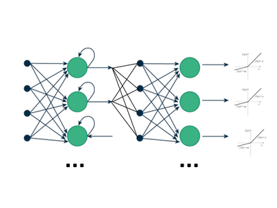

Following this, I developed another model which is diagrammed above:
  1. Encode the sequence using an LSTM
  2. Use a MLP (Multilayer perceptron with linear and ReLU layers) to take the encoded representation and map it to 5 classes (the fifth being nothing)
The graphs show some sample outputs.

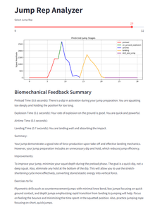

Step 8: (Bonus) Interpret RNN Output
Using Principal Component Analysis (PCA), the series (t=num_time_steps) of vectors output from the LSTM can be visualized. Each 128 dimensional vector can be reduced to two latent components using (PCA). Then, through each timestep, this can be plotted. A pattern is clearly apparent as each timestep follows a pattern across what we call a "latent trajectory."

Gemini API
Now, I'm no sports therapist, so the data above is uninterpretable for me. However, RAG-powered LLM's like Gemini may be able to interpret this data. Therefore, with some crafty prompt engineering and relevant data, a very own sports therapist can be integrated into this wearable monitoring device!
To get a free API key, create a new project in google AI studio and then press get an API key. Its just as simple as that and completely free. Follow this video if you are having difficulties: https://www.youtube.com/watch?v=6BRyynZkvf0
The code below shows how you can get prompting right away in python!
model = genai.Client(api_key='YOUR_KEY')
response = model.models.generate_content(model="gemini-2.0-flash", contents="Hey what's up?")
Prompt engineering is a very important topic in today's world surrounded by LLM's. Learning to use these powerful tools is integral to success. For a very specific topic like analyzing jump biomechanics, you can't just say "look at this data and tell me if the athlete is good or not." There is a reason prompt engineering is actually a job now! A good prompt (there are way better out there follows the below structure):
  1. Role/Context
  2. Input
  3. How to respond (output format)
  4. What not to do
In my task, this was my prompt:
"""You are a professional sports therapist. You are an expert in athletic jump biomechanics, optimized for basketball and volleyball. The below information is regarding a single rep of a jump.
Give feedback as a summary to the user based on the dictionary, including how to improve their flaws with form adjustments, exercises, etc.
Do not affirm the message or ask questions. Just explain the feedback directly. Avoid making text bold. When applicable, give exact exercises. Segment the output into the times (seconds)
each stage took ("features" dict within main dict) and then a summary and then improvements and how to fix."""

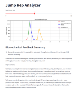

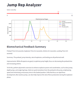

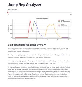

Step 10: Interface Design
Next, I combined the output of the Gemini Model with the labeled graph. Using streamlit, I developed a web interface that currently, for simplicity, analyzing all the samples in the dataset (dataloader). Above are some of the different outputs, highlighting the advanced capabilities of the LLM and the RNN-MLP model.
