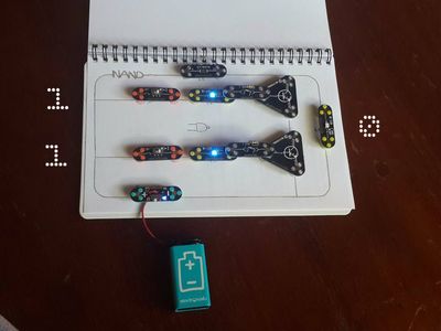

The above pic is the end result you’re looking to achieve. Trace the individual module’s on a sheet of paper using the circuit stencil and your conductive ink pen. Take note of spacing. Depending on how much room you have you can organize the space as you wish. My circuit diagram is made in the circuitscribe sketchbook so it should be able to fit on A5 and above. I also labelled placeholders for my modules to make future referencing easier
Connect the dots and be careful not to bridge any sections that shouldn’t be bridged! Don’t leave any gaps either

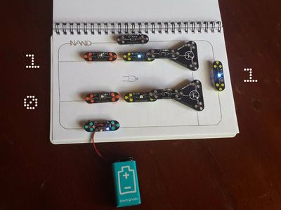

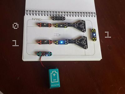

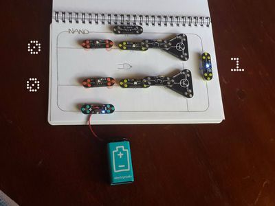

Your NAND logic should work out as follows:
0 0 1
0 1 1
1 0 1
1 1 0
Mine worked like a charm. How did you do?
