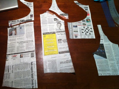

First layout your tank top on the newspaper, lining up the edge of the newspaper with the center front or back of the tank top. Trace around the tank (figure 1). Double check that the measurements are at least in the correct ballpark by measuring the unstretched bust, waist, and hem circumferences of the tank top and matching those to the patterns measurements. (This is where I went wrong the first time around, and trust me, not having to take everything apart is awesome, so measure twice and cut once!) Use the curved rulers to smooth out the curved lines of the garment - in this case all seamlines have a slight curve except for the shoulder seams and then cut out the pattern pieces (figure 2). If you plan to add a shelf bra, copy the original front and back patterns to a new piece of newspaper and then cut off the torso to the correct length to go over your bust. Make sure to add an extra 1" to the length for the elastic casing!
Because I knew I wanted to have a contrast material, I drew lines on the front and back pattern where I wanted seamlines, cut them apart and then added seam allowances (generally I add 5/8"). Since we are finishing the neckline and armholes with binding material, do not add seam allowances there. Otherwise, add seam allowances and a hem allowance.

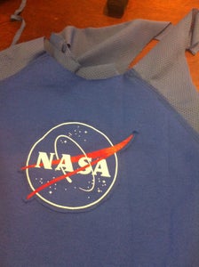

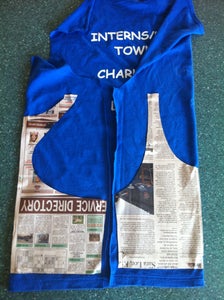

First, I recommend cutting off the sleeves, it makes the process a bit easier. Lay out your pattern peices on the fabric - you'll likely have to be creative in getting them all to fit on the fabric, so take your time. In this case, I only cut out the front part of the tank top in the t-shirt fabric (figure 1), plus I used the back side for the interior bra (figure 2). I ended up needing to cut out the NASA logo and applique-ing it later onto the front of the shirt. Fold the t-shirt over appropriately to get a nice center front fold, place the pattern on it, and cut it out.
Cut the remaining pieces out using the secondary fabric, including some lengths of 1.75" binding. For the binding, if you are using a stretch material, you can cut it on the lengthwise or crosswise grain - I recommend the less stretchy grain, but either will work. If, for some reason, you are using a non-stretch material, cut it out on the bias or else you'll have problems later on.

The next major step covers lots of little steps - sewing the shirt together. I recommend sewing the logo on the front first, as it is easiest to get around the funny shapes before putting the whole shirt together. Sew the contrast straps on, then the sideseams, shoulder seams, and then hem. Following that order makes things go a bit smoother. I chose to topstitch the seams on the front and back twice, as double seams are an athletic-wear marker. You can use a double-needle attachment, but I don't have one of those, so I just topstitched twice. I finished all my seams that were not topstitched with an overlocker. If you don't have an overlocker, I recommend zigzag stitching the seam allowance and then cutting the seam allowance with pinking scissors to finish.
