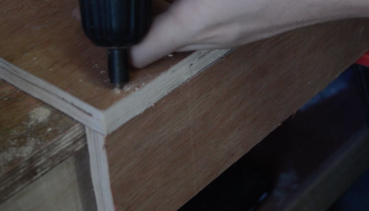

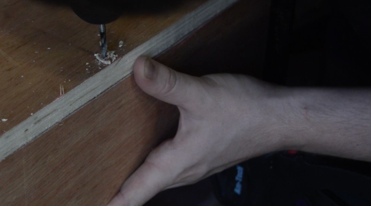

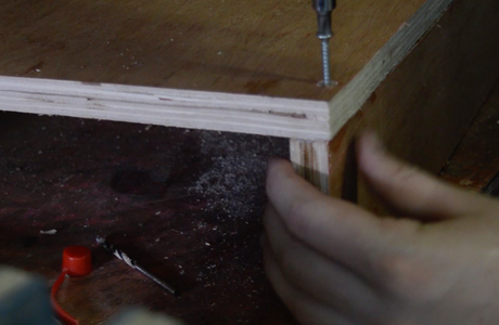

I wanted this box to be able to take some abuse (I'd like it to be usable in space!) As such, I used glue and screws to secure the entire body together. The holes were countersunk so that the head of the screws would sit below the surface of the wood and not scratch up any tables, flooring etc.
