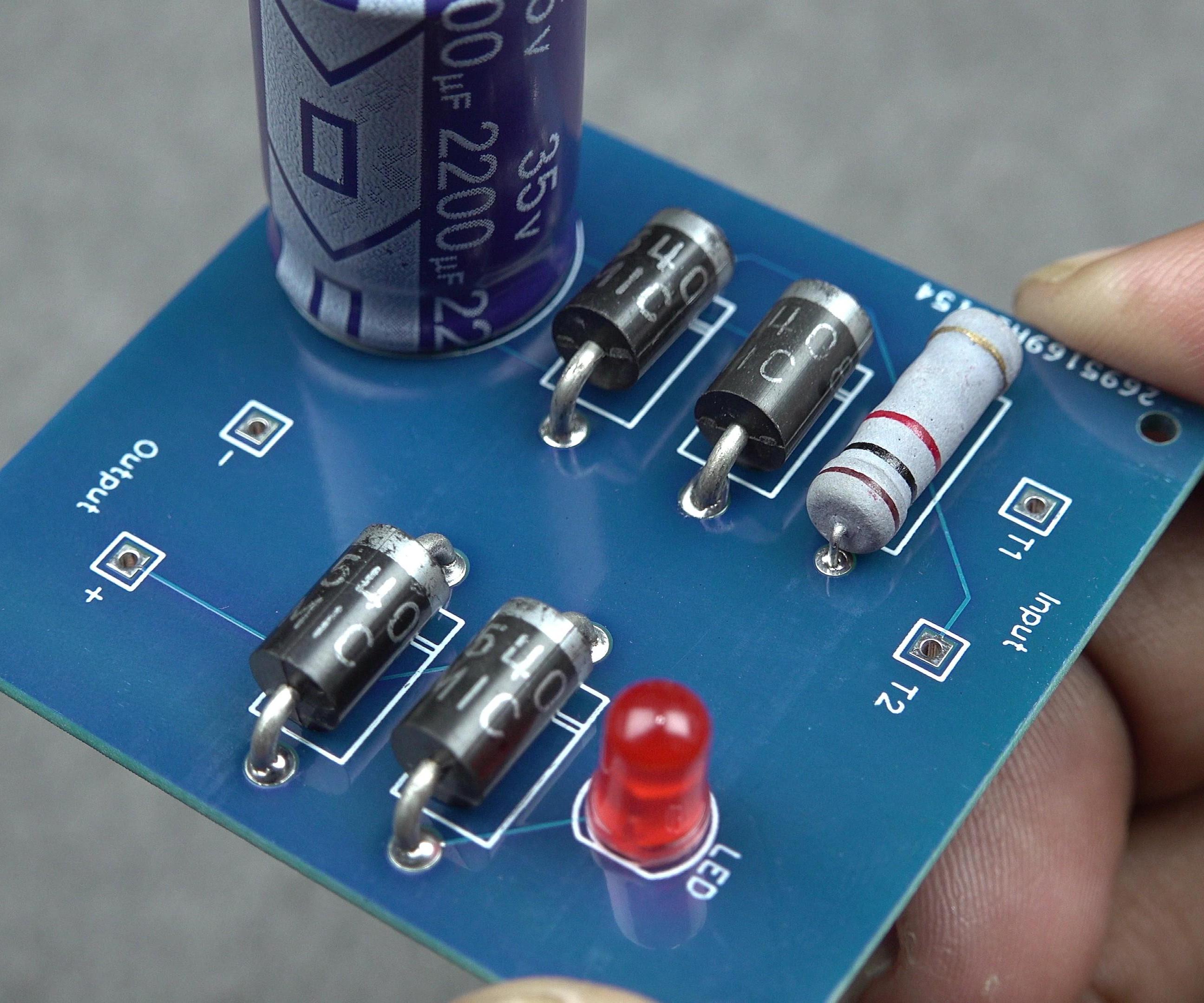

Step 10: Circuit Connection – Step 4
We know that, there are two polarity terminal of a diode. To make this bridge connection, we connect two diode negative terminal and connect two diode positive terminal with the circuit. Then connect, two set diode positive leg with another diode negative leg and connect other terminal with the circuit. It’s a complete bridge connection.
To filter voltage, we need to use a capacitor with the circuit. We are using 1000µf/ 25v capacitor with this circuit. We connect capacitor negative leg with diode negative leg and connect capacitor positive leg with diode positive leg.
Step 11: Circuit Connection – Step 5
For indicator, now we connect resistor and LED with the circuit. We are using 1k resistor to make this circuit. We connect resistor with capacitor positive leg and connect LED positive leg with resistor. Then connect LED negative leg with positive & negative leg of diode
For power source we are using 12v transformer. If we want to make 15v power supply, for that we need to connect 15v transformer. Now we connect transformer secondary section with the circuit. We connect secondary section cable with diode positive and negative leg.
