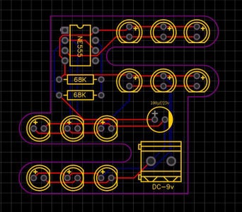

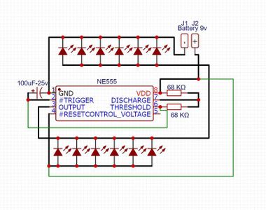

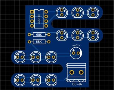

The schematic of LED flasher circuit along with the PCB layout can be seen above. Power supply don’t included with the circuit. You can use any 9v battery for this project. For better effect, you can use different colors LED light and can place them in a rhythm.

To make this circuit, we need to follow a normal method of this time IC. 1st we need to connect 2 and 6 no leg of timer IC-NE555. Then we connect 4 and 8 no leg of NE-555 timer IC. It is a common connection for NE555 IC circuit. Specially, if you want to make a LED light effect project. Remember, to make led light flasher circuit using NE-555 ic you might need this connection.
Step 4: Connect Capacitor With PCBS
Now we connect 100µf/ 35v capacitor with the circuit. We connect capacitor negative leg with 1no leg of timer IC and connect capacitor positive leg with 2no leg of timer IC.
Step 5: Connect Resistor With PCBS
To make this circuit, we are using 68 KΩ resistor. We also can use 1KΩ and 68 KΩ resistor to make this circuit. To make this circuit, we need to make a parallel connection between one terminal of this two resistor. We connect parallel side with 7no led of timer IC and connect two different terminal with 6 and 8 no leg of timer IC.
Step 6: Connect LED Light With PCBS
For better effect, we are using 12 piece led light circuit. We divide this led into 2 side. Then each side will contain 6 LEDS. Then we make a parallel connection in this 6 LEDS.
Now we make a series connection in this two side LEDS. Now we get 3 side. Connect this series side with 3no leg of timer IC. Connect negative side led with 4 no leg of timer IC and positive side led with 4no leg of timer IC.
Step 7: Soldering and Cleaning
Neat and perfect soldering is an important part for all kind of PCBs. Since soldering, you should remember that, there should not be any kind of short circuit connection. After soldering all leg, we cut-off the extra leg of all electronics component.
We also can use liquid PCB cleaner to clean the PCB board.
