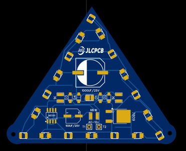

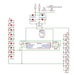

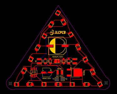

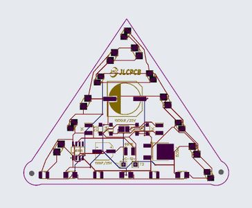

Step 5: Schematics and PCB Design
The schematics of PCBs can be seen above. Again thanks to JLCPCB, for such a quality PCBs.
Step 6: Circuit Connection – Step 1
To make this circuit, we need to follow a normal method of this time IC. 1st we need to connect 2 and 6 no leg of timer IC-NE555. Then we connect 4 and 8 no leg of NE-555 timer IC. It is a common connection for NE555 IC circuit. Specially, if you want to make a LED light effect project.
Remember, to make led light flasher circuit using NE-555 IC you might need this connection.
Now we connect 100µf/ 25v capacitor with the circuit. We connect capacitor negative leg with 1no leg of timer IC and connect capacitor positive leg with 2no leg of timer IC.
To make this circuit, we are using 68 KΩ resistor. We also can use 1KΩ and 68 KΩ resistor to make this circuit. To make this circuit, we need to make a parallel connection between one terminal of this two resistor.
We connect parallel side with 7no led of timer IC and connect two different terminal with 6 and 8 no leg of timer IC.
Step 7: Circuit Connection – Step 2
For better effect, we are using 12 piece led light circuit. We divide this led into 2 side. Then each side will contain 6 LEDS. Then we make a parallel connection in this 6 LEDS.
Now we make a series connection in this two side LEDS. Now we get 3 side . Connect this series side with 3no leg of timer IC. Connect negative side led with 4 no leg of timer IC and positive side led with 4no leg of timer IC.
For power supply, we are using DC 9v. You can use 9v battery or can use the power supply, that can provide DC 9v. Be careful about the power supply, because if you use more than 9v , then led light will blown away and the circuit may damage also.
