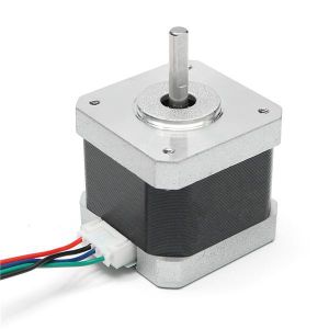

  • Stepper motor NEMA 17

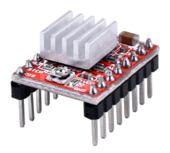

  • A4988 Stepper Motor Driver or (DRV8825)

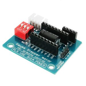

If using a Stepper Motor Driver Shield:
  • Connect Motor Shield GND pin to Arduino negative pin [GND]
  • Connect Motor Shield [5V] pin to Arduino positive pin [5V]
  • Connect Motor Shield GND pin to Power Supply negative pin [GND]
  • Connect Motor Shield [9V] pin to Power Supply positive pin [+]
  • Connect Motor Shield pin[S] to Arduino digital pin [2]
  • Connect Motor Shield pin[D] to Arduino digital pin [3]
  • Connect stepper motor as shown on the picture.

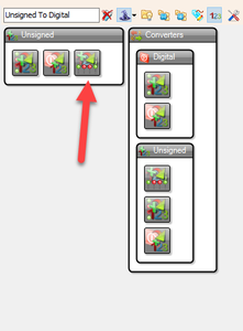

  • Add "Unsigned To Digital" component

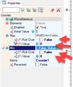

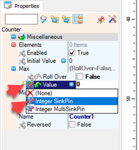

  • Select "Counter1" and in the properties window select "Max" > "Value" and click on the Pin Icon and select "Integer SinkPin"
  • Select "Counter1" and in the properties window set "Max" > "Value" to 0 and "Roll over" to False
  • Select "Counter1" and in the properties window set "Min" > "Value" to 0 and "Roll over" to False

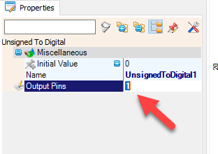

  • Select "UnsignedToDigital1" and in the properties window set "Output Pins" to 1

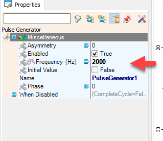

  • Select "PulseGenerator1" and in the properties window set "Frequency" to 2000 << this will be the speed of the stepper motor, you can adjust it to your needs

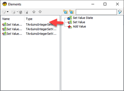

  • Double click on the "IntegerValue1" and in the Elements window drag "Set Value" to the left side and in the properties window set "Value" to 1000
  • drag another "Set Value" to the left side and in the properties window set "Value" to 800
  • drag another "Set Value" to the left side and in the properties window set "Value" to 3000
  • Close the Elements window

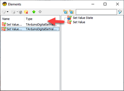

  • Double click on the "DigitalValue1" and in the Elements window drag "Set Value" to the left side
  • drag another "Set Value" to the left side and in the properties window set "Value" to True

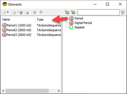

  • Double click on the "Sequence1" and in the Elements window drag "Period" to the left side
  • drag another "Period" to the left side and in the properties window set "Delay" to 2000

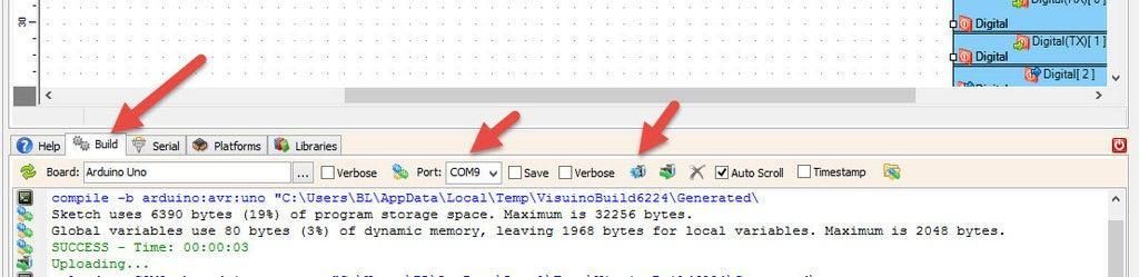

Step 8: Generate, Compile, and Upload the Arduino Code
In Visuino, at the bottom click on the "Build" Tab, make sure the correct port is selected, then click on the "Compile/Build and Upload" button.
