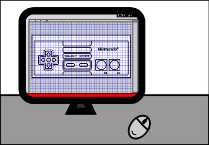

Step 1: Create Design
The first step, of course, is to create the design; this will give you an idea of what it will look like, and will come in handy later on when you need to raster on the design. Either create this yourself, or use my one.
I used a combination of Microsoft Word (general formatting), AutoCad (drawing up final design/printing) and Google Sketchup (working out dimensions/original concept)
Tip: try to make sure that the design is not at all pixellated, as this will show when the clock is rastered (I learnt this the hard way!) Also, ensure you make the design in line-art form, with everything as you want it to appear on the actual clock (so no fill apart from the letters)

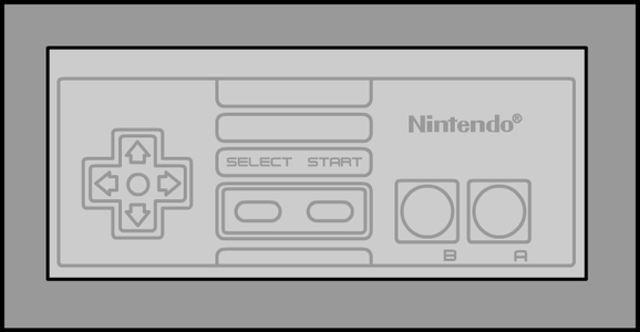

Step 3: Rastering the Design
Now comes the hardest/easiest bit, depending on your access to a laser engraver machine. Obviously, if you have one of these expensive machines lying around the house somewhere you shouldn't have a problem. Chances are that you don't, though. If your local workshop/tech club has one then try to use that, and ask a regular visitor, or other knowledgeable person how to use it.
Using your line-art design from before, raster your design onto the clock, with cutting mode off. Make sure all the dimensions are exact, and make sure the clock is lined up correctly (otherwise the final raster may be off center, or on an angle)
There are probably other ways that you could do this, but rastering is easier and usually gives a better result.

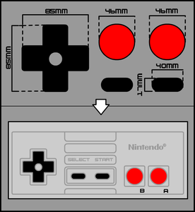

Step 4: Creating the Buttons
You may skip this step if you don't have any plastic avaliable, or if you prefer the raster design by itself.
Now for the buttons! Here you will need to create the designs for the buttons. If you have Vectorworks, use that: the vectors will ensure that there is no risk of pixelation or distortion.
Create 2 circles with a diameter of 46mm (or whatever it is in your design), a d-pad 85 x 85mm and start/select buttons 40 x 17mm. Cut these out of red plastic for the A and B buttons and black plastic for the others, making sure the plastic is not too thick as if it is it will stop the hands from travelling around the clock. Mine were 4mm wide, but this width can vary depending on the width of your clock.
Finally, glue these onto the clock using plastic glue; be careful not to shift the buttons or mis-glue them, if you have to take it off it leaves a horrible mark on the wood!
