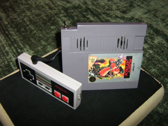

So a while back I saw where someone had done a NES controller mod and turned it into a MP3 player. This is my version of this mod. Hope you like it.
BTW, I used a Coby 512MB MP3 player.
And check out www.straightrazorplace.com if you get a chance. Its a great place.
Here is a video of it playing with the speakers I made for it.

Step 11: DONE!!!
You should now have a working NES Controller MP3 player for under $30.
Enjoy and feel free to ask me if you have a problem.
