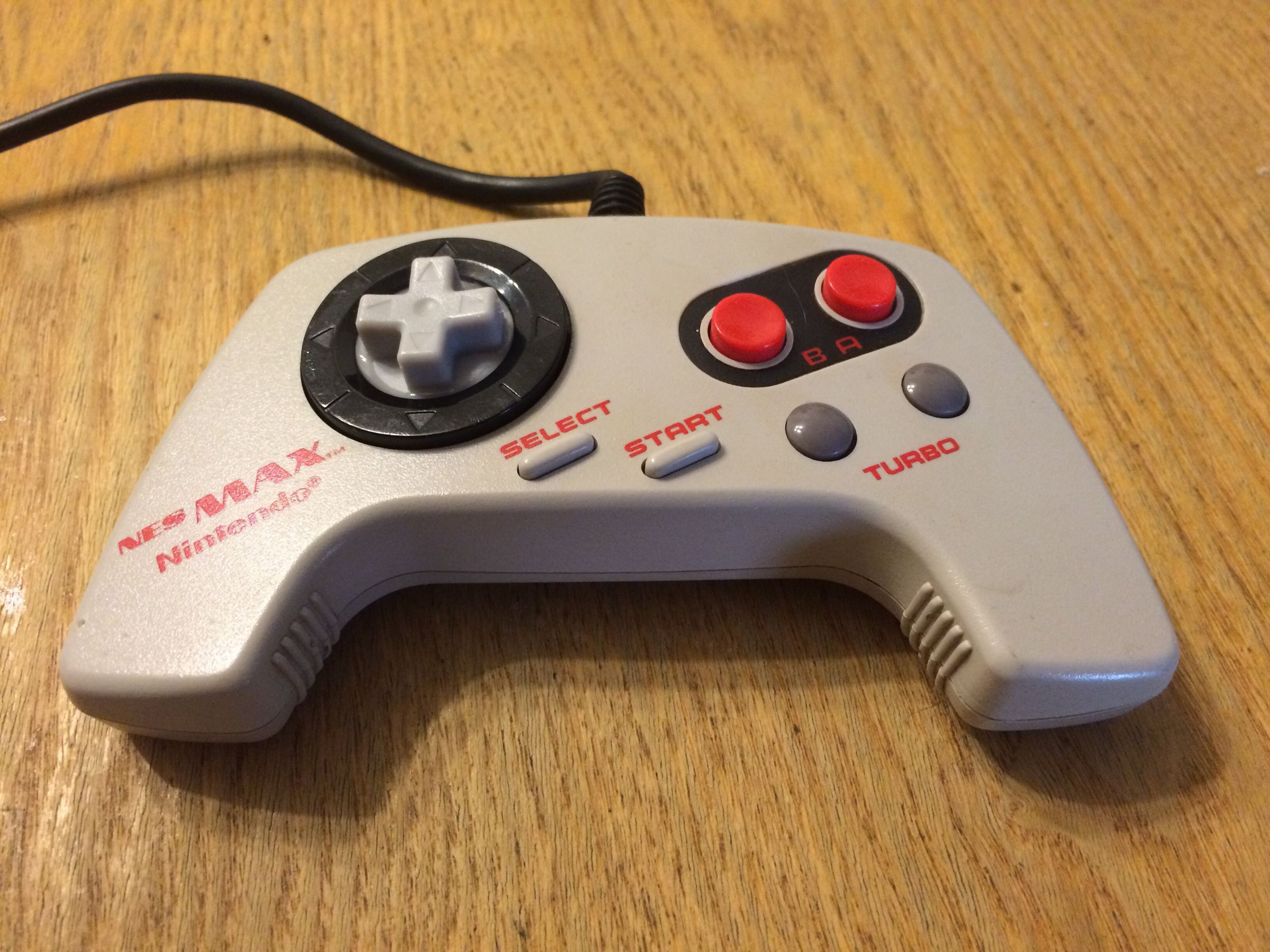

Ahh, the NES MAX controller. I've owned one since the early 90's and have wanted to love it ever since. It has standard "B" and "A" buttons as well as TURBO "B" and "A" buttons. The TURBO buttons are the real draw of this 1st party controller, but the directional pad (AKA the "cycloid") is terrible. Now, if there was only a way to replace that clumsy directional pad...
Upon taking my NES MAX apart to clean it, I discovered that it would be possible to replace the red sliding piece of the cycloid with a D-pad from a GameCube controller or a Game Boy Color (some modification to the D-pad would be necessary of course). Since I didn't have spares at the time, I looked for another alternative. The D-pads from most of my other controllers were too large, so I turned to a couple of old "Super Controllers" with a joystick that would do just fine. What's a Super Controller? It's a 3rd party accessory made by BANDAI for the original NES brick controller. It basically turns the D-pad into a miniature joystick. I've always found the Super Controller to be very... well... un-super, so I had no problem cannibalizing the joystick from one.
