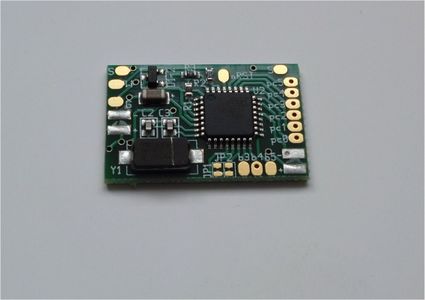

Step 2: USB Converter PCB
The original electronic inside the NES gamepad can not drive an USB port. We need an additional pcb with this function. You can buy an assembled pcb called NES, SNES, DB9 (Atari/SMS/Genesis) or TGFX16/PC-Engine to USB conversion circuit with the required function from the Canadian Website Raphnet.net
Step 3: Prepare the USB PCB
The USB pcb supports different operation modes for SNES and NES. We have to set the rigt mode by soldering a bridge to JP1.

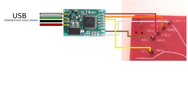

Step 4: Solder the Cables to the USB Pcb
Solder now the cables from the old pcb to the usb pcb. Furthermore you need an standard USB cable. Cut the USB-B plug and dismantle this cable and solder the 4 wires inside also to the USB pcb.

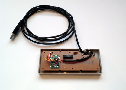

Step 5: Mount the Pcbs and the USB Cable
Fix the USB pcb with self adhesive tape to the old pcb of the NES controller. Mount the USB cable as in the picture and close the enlosure.

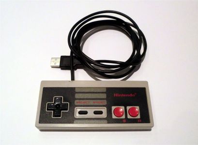

Now your new retro game controller is ready for gaming.
