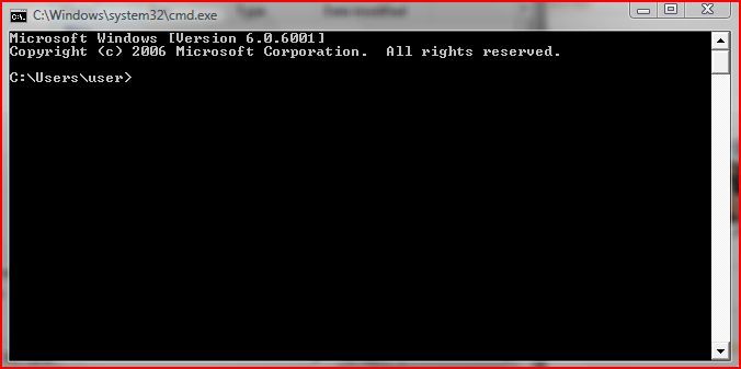

Introduction: NETsend With VBScripting
Ok so it's not totally with VBScripting, but I think that VBScripting InputBoxes and Msgboxes look much more user friendly than inputting into a cmd window.
Oh and btw, Please don't write "MUCH EASIER WAY..."
Cause yes we all know that you can open up cmd and type "Net send computername yourmessagehere"
This is just a more user friendly way of doing it.
