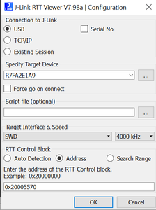

Step 3: View NFC Tag Output Via SEGGER RTT Viewer
To verify if your NFC tag is being correctly detected and authenticated, you’ll use SEGGER RTT Viewer, a powerful debugging console that prints real-time logs from the RA2E1 board.
How to Setup SEGGER RTT Viewer
Follow these steps carefully:
1. Locate the SEGGER Address
  1. After building the project, go to the Debug folder inside your project.
RA2E1_nfc_dataFlash → Debug
  1. Open the file named:
RA2E1_nfc_dataFlash.map
  1. Press Ctrl + F and search for _SEGGER_RTT.
  2. Copy the address listed beside _SEGGER_RTT.
  3. It will look like:
_SEGGER_RTT 0x20005570
2. Launch SEGGER RTT Viewer
  1. Open the SEGGER RTT Viewer application.
  2. Select the correct device part number(You can verify the part number in configuration.xml → BSP tab → Device Name).
  3. In the setup window:
  4. Select J-Link Device as your RA2E1 board.
  5. Choose Interface = SWD
  6. In the RTT Control Block section, paste the address you copied from .map file (e.g., 0x20000400).
  7. Click OK.
3. Monitor Output
Once connected:
  1. You’ll start seeing real-time logs in SEGGER RTT Viewer.
  2. Bring an NFC tag close to the reader.
  3. If the UID matches the one you hardcoded earlier, you’ll see:
AUTHENTICATED: UID matched A1B2C3D4
DataFlash Read: Hello Renesas!
If the UID does not match, you’ll see:
UNAUTHENTICATED: UID did NOT match
Note: Only tags with static UIDs (not randomly generated each time) can be reliably authenticated in this setup.
We recommend you use tags with fixed UID, these are often labeled as “NTAG213,” “NTAG215,” etc.
