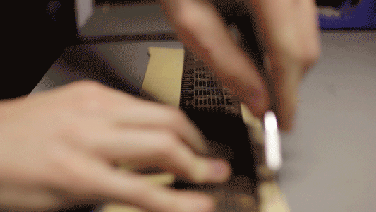

Here you will want to cut the veneers into small strips that are capable of wrapping around your desired finger at least 4 times. The strips need to be cut a few mm wider than the width of the NFC tag to allow for sanding after.

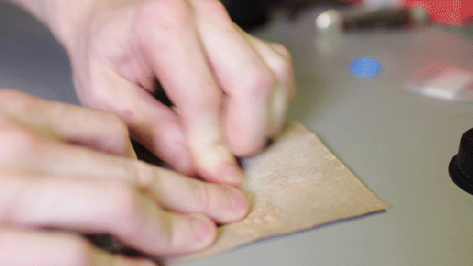

Now that you have your coil of veneer that is very well dry, determine the proper length they need to be. If they are longer than you need then trim them to proper length. Take each end of the veneer and sand the end so that they taper off to a finer point. This will help hide the ends when you glue them together.

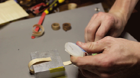

At this point you can begin rolling your veneer around the dowel or pipe you're using. Apply a bit of tape around the round piece, you can also add more tape if you want to make it slightly larger. Glue every bit as you go along. Try not to glue your fingers to it - really try hard! Don't be stingy on the glue, the more you use, the stronger the ring will be, just try not to get it everywhere, and try not to glue to the tape. If you do you can sand it off later.
Only roll 2.5 rolls at this point and stop gluing!

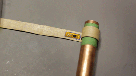

Step 7: Cut Slot for NFC Tag and Glue It In.
Now that its partially rolled and you have giving a bit of time to dry. Trace around the NFC tag on the inside of the wooden ring close to the glued roll. Use the exacto to very carefully cut out this section of wood to allow the NFC tag to sit in. Take your time or you could ruin your ring at this point if you cut it in half or something.
Ones the slot is cut continue gluing the ring as before but stop after the slot is glued down. Now it is time to add the NFC tag in the slot you just cut. apply the flat side of the tag down.

The fun part. Now that the ring is dry and set, sand down the sides of the ring to your desired width. You may want to mark where the NFC tag is in pencil on the outside so you know how close you can get to is while sanding. Sound the inside until it fits your finger. This is why there is more space on the inside than the outside. You want to be able to make it larger from the inside while not sanding into the NFC tag. The outside only has 1 layer covering the NFC tag so keep that in mind.
If you have a demel available, I like to add a bunch of tape to a sanding piece wide enough to jam the ring on. This allows me to sand the ring much faster using the rotation of the demel motor. Makes it really even too. You could use a drill or drill press also.
