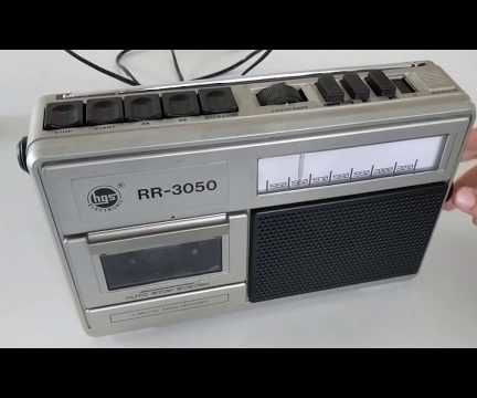

In a lab project at the department of human-centered ubiquitous media we were challenged to create a modern music player which references traditional radio design. The timeframe was one semester.
