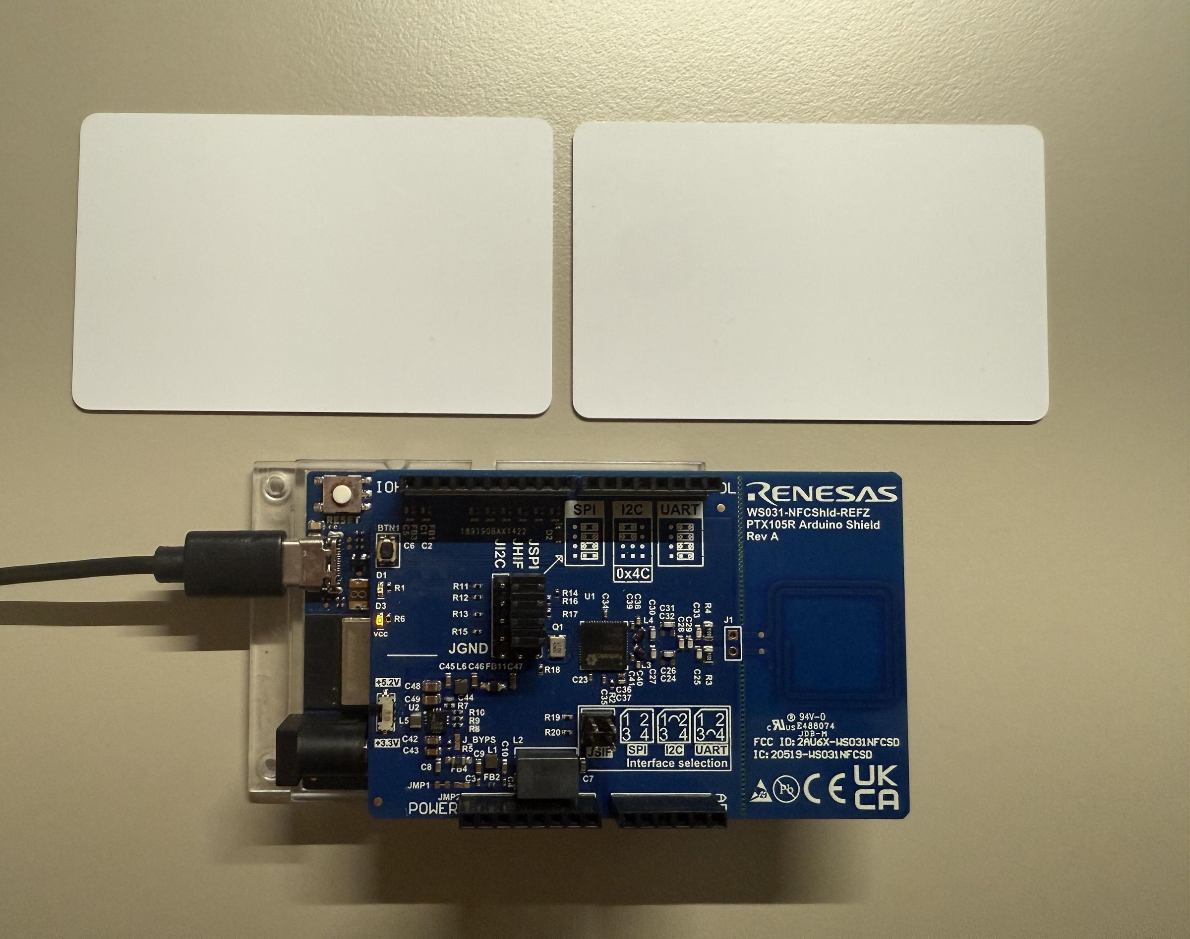

  1. Arduino IDE
  2. Arduino Uno R4 WiFi or Minima
  3. Renesas PTX105R NFC shield
  4. NDEF-formatted NFC tag of Type 2, 3, 4 or 5

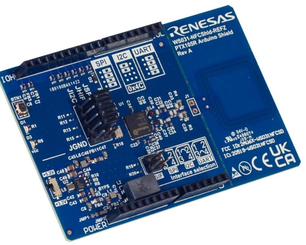

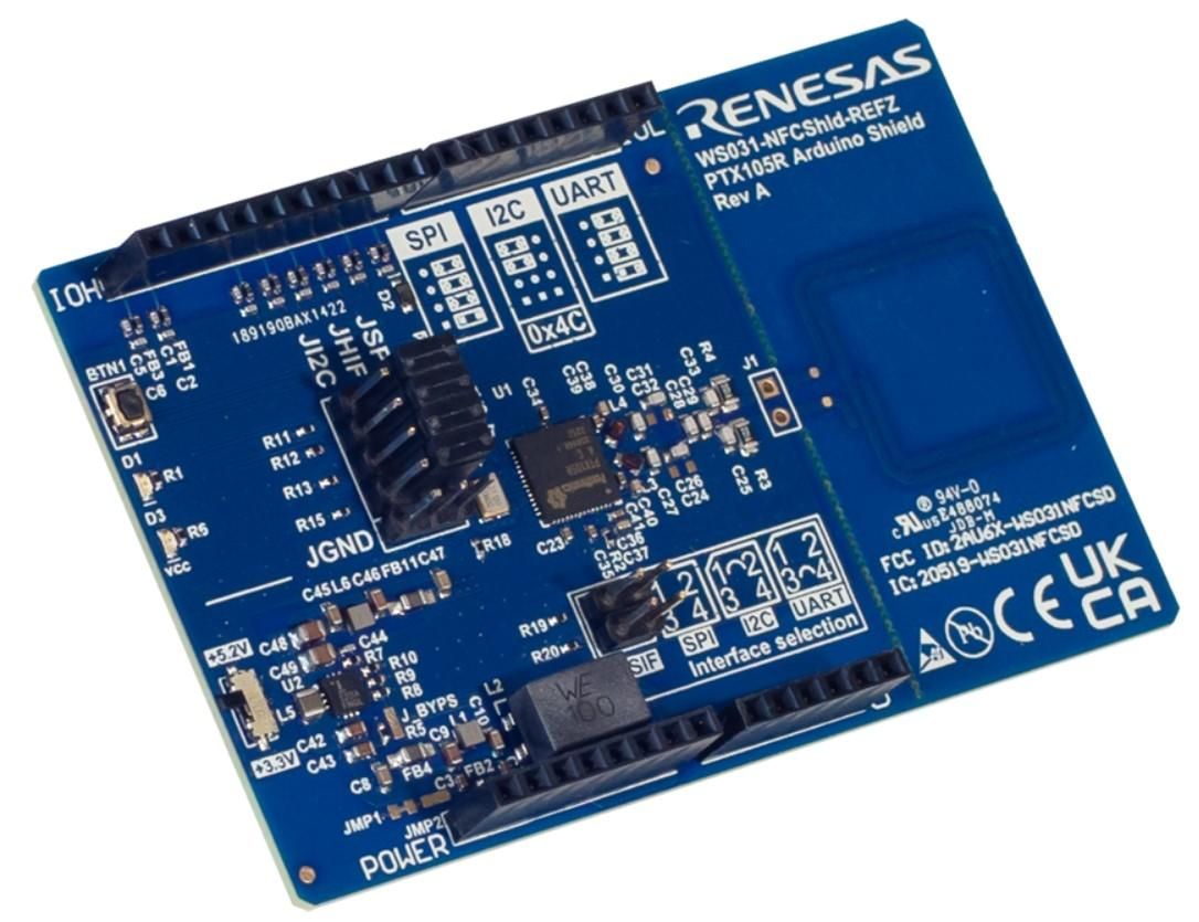

Step 1: Configure the Shield
The shield can be configured to use the SPI, I2C or UART interface, by arranging the pin-caps. The out-of-the-box configuration is SPI.

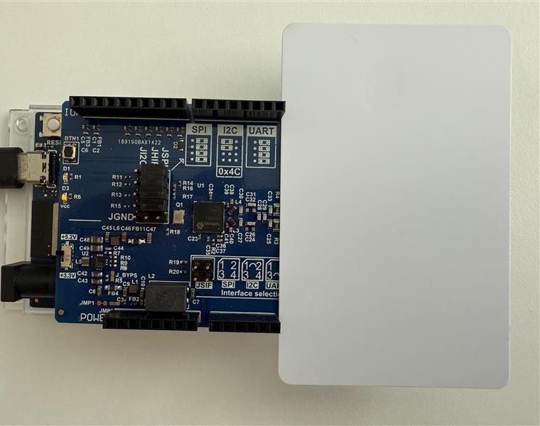

Step 4: Write Text Record to Card
  1. Make sure the initial instructions are displayed on the Serial Monitor.
  2. Place an NDEF-formatted card on the antenna.
  3. Type a text into the Serial Monitor and press Enter.
  4. Information about the card and the text record will be displayed on the Serial Monitor
