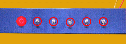

Using six 5mm LED’s, the display can be placed in the front of a car to give a very artistic effect.

The LED’s may be fixed with a spacing of say 1” to ¾” apart.

The assembled Night Runner circuit is shown in this photograph.
For easy assembly first fix the bases of the IC 555 and IC 4017 to the box and mark the legs as 1,2,3,4,5,6,7,8 and so on, so that you will not get confused while soldering the connections to it.
