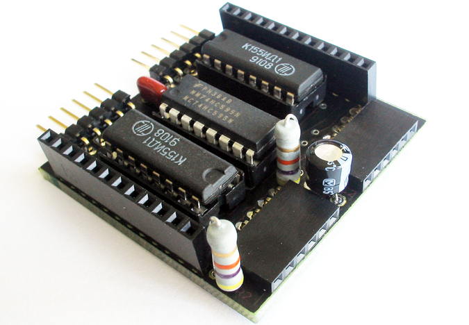

The HV+ and HV- labels on the nixie tube power supply correspond with HV and gnd on the nixie tube driver module.
The HV- lead connects to pin 1 of SV1 (gnd), and the HV lead connects to pin 4 of SV1. For SV1 and SV4, pins 1, 2, 5, and 6 are all connected to gnd.
Only pins 3 and 4 of SV1 and SV2 carry the high voltage required by the nixie tubes.

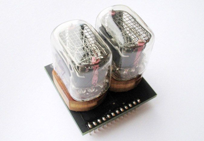

Now that you have power supplied to the nixie tube driver modules, you should see all the elements in both nixie tube digits illuminated.
Use caution not to touch the high voltage output to the nixie tube driver modules. There is potentially enough energy here to cause a severe shock.
When nixie tube driver modules are connected edge-to-edge, left-to-right, both high voltage power and serial data from the external microcontroller are threaded through to all the boards.
A microcontroller is required to take full advantage of the nixie tube driver module shift register chain. The nixie tube driver module permits a microcontroller ( Arduino, etc.) to address two nixie tube digits, and via this shift register chain, multiple pairs of nixie tube digits.
For an example of how the nixie tube driver modules may be supported by an external microcontroller, see the sample Arduino digits driver code. Multiple nixie tube driver modules are seen operating together in the nixie tube driver module movie.
Depending how brightly you wish your nixie tubes to be illuminated, you can adjust VR1 to generate output between 170 and 250 volts DC. Increasing the output power will also allow you to drive more nixie tubes simultaneously.
