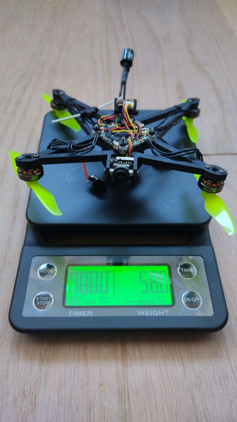

I strongly recommend printing all parts with ABS. PLA(+) will work too, but it is very temperature sensitive and will deform over time. PETG is ok, but too flexible for my taste. I'm using Esun ABS+. My printing settings were 0.2 resolution and 20% infill.
If you want to save 6g, you can CNC cut the frame from 1.5mm carbonfibre. There is a .svg file on the Thingiverse deposit as well.

Before starting the build, you should decide I went for a push prop setup, do avoid propeller in the view. I also opted for the 21700 battery mount and to install it under the frame. Alternatively you could use no mount, the 18650 battery mount or installation on top of the frame.
- Use M2 screws to build the drone. The battery mount is connected with 2 16-20mm M2 screws. You need 2 additional screws to mount the Flight controller. Titanium screws will help to save weight.
- If you decide to use the optional GPS, put the 3d printed mount on top of the rear screw.
- Put the flight controller on the 4 screws using grommets.
- Install motors using two M2x6mm screws per motor.
- Press fit propellers on the motors. Ensure correct direction according to your Betaflight setup. You can use 2 screws per prop, but I decided to skip them and save weight.
