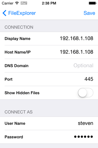

On iPhone/iPad
- Download the app File Explorer
- Tap the "+" button, then select "Computer, NAS" item.
- Input the IP address (you can find it in the top left corner of Settings app in Prota Space) and leave the DNS Domain field blank.
- Input “nfs” as username and the password you set previously.
- Click on Save
Your NFS server is now connected to your device and you can open remotely all your files, copy them or add new ones. It makes it very easy to access this server as the server folder is directly visible on the left side of your computer’s file explorer.
