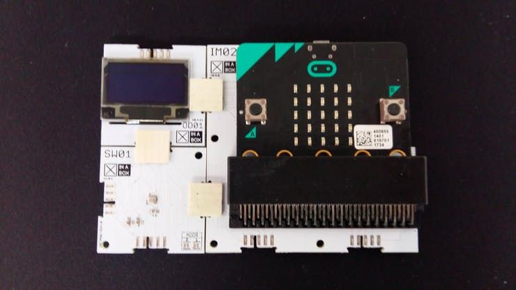

Step 3: Assemble the Circuit
- Click the OD01 and SW01 together using a xBUS connector (from the XC10 pack).
Figure 1: Connected SW01 and OD01
- Click 2 xBUS connectors to the left side of the IM02 then click on the connected SW01 and OD01. Make sure that the xChips faces the same way up, so you can see the SW01 name and the IM02 name both facing up.
Figure 2: Connected IM02, SW01 and OD01
- Use another xBUS connector to connect the MD01 to the PB04. Set aside the connected PB04 and MD01 with 3 xBUS connectors and the AA batteries.
- Click the Micro:Bit into the IM02. Make sure the LEDs faces up - same way as the SW01 name and the IM02 name.
Figure 3: Connected IM02, SW01, OD01 and Micro:bit
- Attach a Micro-USB connection from your computer to the Micro:Bit. Notice the yellow LED on the bottom side turning on.

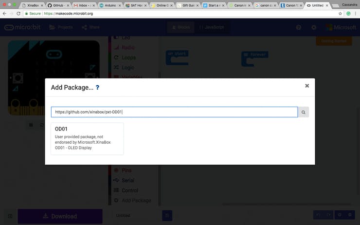

Step 4: Install Package
- Open a browser and go to makecode.microbit.org
- Scroll down to "Advanced"
- Then Scroll down to "Add Package"
Figure 4: Finding "Add Package"
- Search for "weather" and click on "weather-bit" to add the package
- Repeat points 2 and 3
- Then paste this URL into the search bar : https://github.com/xinabox/pxt-OD01 then click on OD01 to add the package
Figure 5: Adding the packages
- You now have all the necessary packages.
