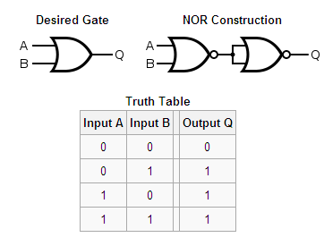

NOR AS OR
The OR gate is simply a NOR gate followed by a NOT gate.
fig 3

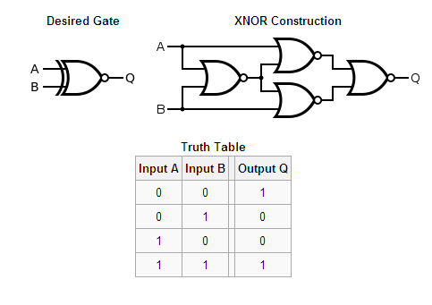

NOR AS XNOR
An XNOR gate can be constructed from four NOR gates implementing the expression "(A NOR N) NOR (B NOR N) where N = A NOR B".This construction has a propagation delay three times that of a single NOR gate, and uses more gates.
fig 7
