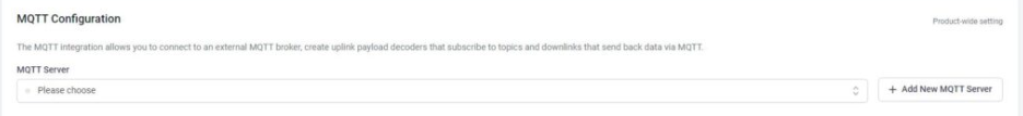

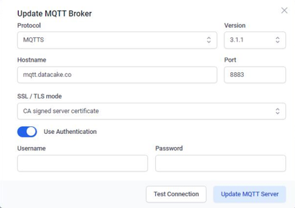

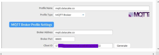

Step 2: Steps to Configure in Mqtt.fx
Check this link for detailed instructions on how to configure the MQTT broker and the Subscriber.
  1. Download MQTT.fx client and install it.
  2. Open the MQTT.fx and click the Settings icon.
  3. Click + to create a profile.
  4. Enter the Connection Profile and General information.
Step 3: Enter the User Credentials Information
Step 4: SSL/TLS
  1. After completing the above steps, click Apply > OK to save.
  2. Then, select the name of the file just created in the profile box and click Connect.
  3. If the round icon in the top-right corner is green, the connection to IoT Hub is successful, and publishing and subscribing operations can be performed.

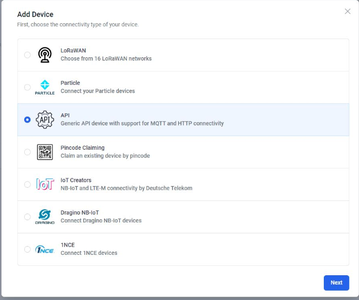

  1. Access the DATACAKE from this link and navigate the Datacake dashboard. Select the “Add Devices”.
Step 8: For the MQTT Integration Select the API
  1. This will add the device to the Datacake account.

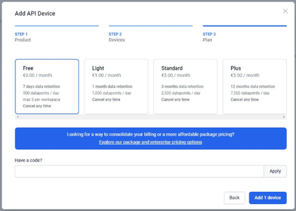

Step 9: Add API Device

  1. Click on Configuration Scroll down a bit and go to the new panel “MQTT Configuration”. Press on “Add New MQTT Broker”. Fill in the server details and add.
Step 11: Update MQTT Broker

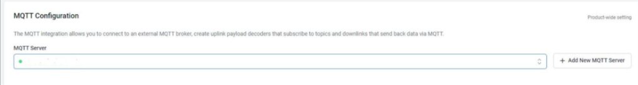

Step 12: MQTT Broker Connected Successfully
