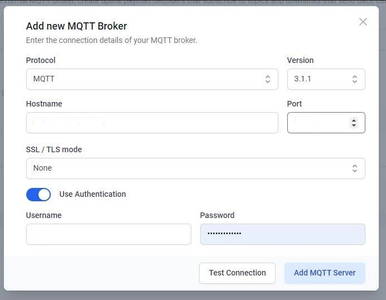

  1. MQTT Broker Details: Input the Datacake MQTT broker, port, and credentials from your Datacake account.
String broker = "mqtt.datacake.co";
String MQTTport = "8883";

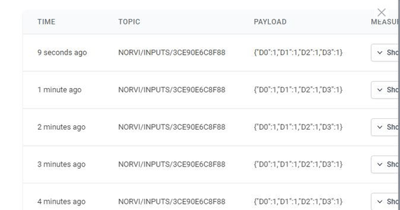

Step 5: Connect the Device to MQTT
Once the firmware is uploaded, the Quectel EC25 will try to connect to your GPRS network and MQTT broker. The device's status and digital inputs will be published to the Datacake MQTT topic.
  1. Check the serial monitor for feedback on GPRS and MQTT connection.
  2. If the device is connected, it will subscribe to the downlink topic for receiving messages and will start publishing sensor data

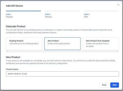

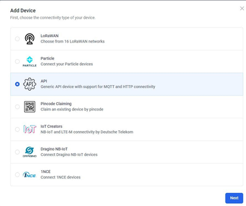

Step 6: Verify the Connection on Datacake
  1. Log in to your Datacake account.
  2. Go to the Devices section to see if your NORVI GSM device is online and receiving data from the EC25 module.
  3. You can now create dashboards and trigger actions based on the MQTT messages sent by the device.

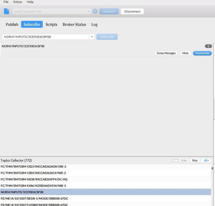

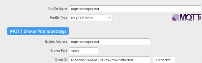

Step 7: Configure the MQTT Broker
  1. Download MQTT.fx client and install it.
  2. Open the MQTT.fx and click the Settings icon.
  3. Click + to create a profile.
  4. Enter the Connection Profile and General information.

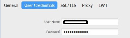

Step 8: Enter the User Credential Information
  1. After completing the above steps, click Apply > OK to save.
  2. Then, select the name of the file just created in the profile box and click Connect.
  3. If the round icon in the top-right corner is green, the connection to IoT Hub is successful, and publishing and subscribing operations can be performed.
Step 9: Connected to the Broker
Step 10: Subscribe to the MQTT Topic
  1. Select the Subscribe tab in the client, scan and select the topic name, and click Subscribe to subscribe to the topic
Step 11: MQTT Subscriber Dashboard
  1. The subscribing result can be seen in the bottom right corner.

  1. Access the DATACAKE from this link and navigate the Datacake dashboard. Select the “Add Devices”.(Datacake dashboard)
Step 13: For the MQTT Integration Select the API.
  1. This will add the device to the Datacake account.
Step 14: Add MQTT Broker Configuration.
  1. Click on Configuration Scroll down a bit and go to the new panel “MQTT Configuration”. Press on “Add New MQTT Broker”. Fill in the server details and add.
Step 15: MQTT Broker Connected Successfully

  1. If the device is already sending data, an indication of incoming data can be seen in the “Last data” column.
Step 18: Data Logs
  1. After the settings in the configuration section, the dashboard can be created. Use the Tab Bar on the Device to navigate into the ”Dashboard” view.
