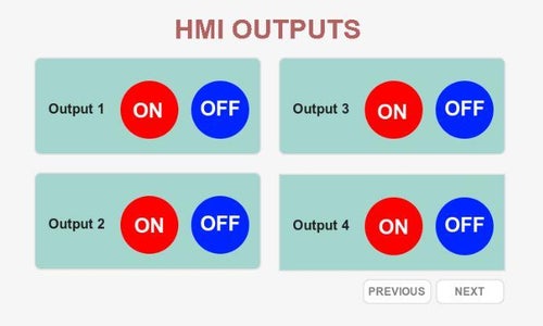

Create a screen for transistor outputs
To create a screen to seamlessly control the transistor outputs. Activate the LED when the "ON" button is pressed and deactivate it when the "OFF" button is selected. Please refer to the SQUARELINE STUDIOS FOR NORVI ESP32 HMI GUI DESIGN.

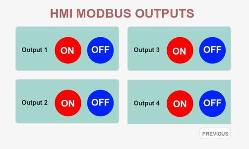

Create a screen for write coils (MODBUS protocol)
The process of NORVI ESP32 HMI acting as a MODBUS master and the interaction between the NORVI device (MODBUS Slave) and NORVI ESP32 HMI through the MODBUS protocol, please refer to the NORVI HMI WITH MODBUS PROTOCOL document. This document examines how to write the coil values of the transistor outputs from the NORVI ESP32 HMI and store the values in the NORVI device (MODBUS Slave).
  • In this project these three parts are added as three separate screens for one GUI design.

Then update that coding part as below. These are for the transistor Outputs and write Modbus commands.
//control the outputs
void OUT1_ON(lv_event_t * e)
  writeOutput(GPIO5, 1);
void OUT1_OFF(lv_event_t * e)
  writeOutput(GPIO5, 0);
void OUT3_ON(lv_event_t * e)
  writeOutput(GPIO7, 1);
void OUT3_OFF(lv_event_t * e)
  writeOutput(GPIO7, 0);
void OUT2_ON(lv_event_t * e)
  writeOutput(GPIO6, 1);
void OUT2_OFF(lv_event_t * e)
  writeOutput(GPIO6, 0);
void OUT4_ON(lv_event_t * e)
  writeOutput(GPIO8, 1);
void OUT4_OFF(lv_event_t * e)
  writeOutput(GPIO8, 0);
//write the modbus commands
uint8_t result;
void button1_on(lv_event_t * e) {
  LED1 = 1;
  result = node.writeSingleCoil(0x00001, LED1);
void button1_off(lv_event_t * e) {
  LED1 = 0;
void button2_on(lv_event_t * e) {
  LED2 = 1;
  result = node.writeSingleCoil(0x00002, LED2);
void button2_off(lv_event_t * e) {
  LED2 = 0;
void button3_on(lv_event_t * e) {
  LED3 = 1;
  result = node.writeSingleCoil(0x00003, LED3);
void button3_off(lv_event_t * e) {
  LED3 = 0;
void button4_on(lv_event_t * e) {
  LED4 = 1;
  result = node.writeSingleCoil(0x00004, LED4);
void button4_off(lv_event_t * e) {
  LED4 = 0;

Functions for handling button events and controlling outputs via Modbus communication.
uint8_t result;
  LED1 = 1;
  LED1 = 0;
  LED2 = 1;
  LED2 = 0;
  LED3 = 1;
  LED3 = 0;
  LED4 = 1;
  LED4 = 0;
